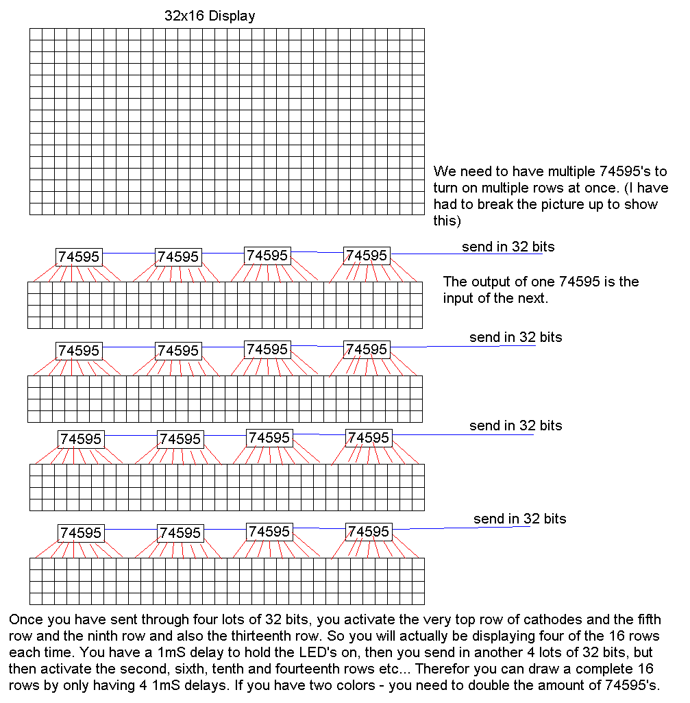

I just realized: I do not know how to adequately power LED matrices.
What I need for right now is to know how to power two or four 2x2 matrix of 8x8 matrices.
Where each x is a 8x8 matrix, what I am making will look sort of like this:
xx xx xx xx
xx xx xx xx
Either all of them will be driven together, or the first two 2x2 matrix of matrices will be driven together, and the other matrices will be driven separately.
So it is effectively going to be either a 2 row and 4 column matrix of matrices, or a 2 row 8 column matrix of matrices, totaling to either a 16x32 or 16x64 pixel matrix.
My hardware:
Arduino
74HC595 shift registers
eight 8x8 matrices (I will eventually get 8 more to double the matrix count.I have yet to decide whether they will be powered by the same Arduino or not.)
Also, it should be noted that I have 74HC373 and '374s, but do not know how to use either. Should I use one of these instead of the '595s?
What I have on hand for current (sinking or sourcing, I'm not sure which.):
resistors
10x ULN2803APG transistor arrays
2n2222a Transistors
I am willing to get whatever I need to properly power the matrices. However, I would prefer, if it would work just as well, to use the transistor arrays I already have to power the matrices.

Re: RPG game + LED pixel game system hardware
Post by brad » Fri Oct 19, 2012 7:00 am
First of all - the video update is so cool! The LCD screen letting you know what is what really adds depth to the game - I guess it's sort of like reading a book. There are no pictures in a novel but you draw the pictures up in your head. This is shaping up to be an extremely fun game to play. Actually, I look forward to playing it once complete!
Now let me do a write up of your other questions...
Post by brad » Fri Oct 19, 2012 8:49 am
Saimaster13 wrote:I just typed up the intro. It now compiles down to 20kb. So what was that about extra memory and serial eeprom?
I would use a serial eeprom (or perhaps SPI memory) to hold onto all of your constants data (like game screens and LCD text etc...)
Post by brad » Fri Oct 19, 2012 10:20 am
Saimaster13 wrote:I just realized: I do not know how to adequately power LED matrices.
xx xx xx xx
xx xx xx xx
My hardware:
Arduino
resistors
2n2222a Transistors
Links:
Link to download ULN datasheet
link to matrix datasheet
The main problem here is the amount of rows being activated at once is not enough. Let's just say that you are sending out 1 bit every 1uS. If you have a bi-color 8x8 matrix then it will take 8*8*2 = 128uS to send out your red and green colors to the display. You then need to allow a delay of perhaps 1mS for each time you activate a row of LED's - so you have and extra 8mS delay for an 8 column display. If you then go worst case scenario and have a 64x16 pixel (bi-color) display then you are looking at needing 16 of these 8x8 matrix displays. so:
128uS to send data out per display + 8mS to actually be able to show the image multiplied by 16 displays = approx 130mS all up. That's just to scan through once. But you need to be updating these displays at a rate of around 24 times a second (to prevent flicker)
But if we run the math 1/0.13 = 7.69. That means that you will only be able to show 7.69 frames per second which means a whole lot of flicker!
So what if you where to use 74373's? Well, this would help, but only slightly - the only difference here is that you are sending a whole byte out to the matrix per clock pulse instead of only sending a single bit per clock pulse. this means that you will wipe out 7uS per row per display So:
7uS * 8 columns * two colors * 16 displays = 1.79mS this means you will have drawn one image 1.79mS quicker than if you sent the data out serially. It did take 130mS previously so now it will take 130mS - 1.79mS = 128.21mS which is still not quick enough!
Notice how we don't really have a problem with how fast we can send out the data? the main problem is with holding the data on those LED's for long enough for us to see them properly. What you need to do is send multiple rows of data out at a time, then turn on multiple rows of LED's at a time, before sending out the new data.
hopefully this picture should help!

I don't understand how I would split an 8x8 matrix into 4 rows. Wouldn't the cathode data be doubled on a single matrix if two rows were active at the same time? Also, to provide the extra mA needed to power larger matrices, won't I need to add some transistors to source and sink power?
