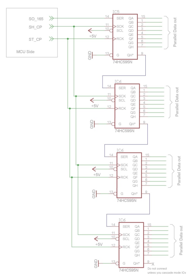

Re: Image conversion software
How do you have the 74595's connected? are they cascaded together?
- semi-newbie
- Posts: 12
- Joined: Wed Jul 02, 2014 7:30 am [phpBB Debug] PHP Warning: in file [ROOT]/vendor/twig/twig/lib/Twig/Extension/Core.php on line 1266: count(): Parameter must be an array or an object that implements Countable
Hi Brad,
Thanks for the feedback
Yes I am using the SPI library of mikroBasic compiler with the PIC18F4550 cascaded 74HC595, but examples of the compiler only have 8-bit transmission.
You would have some connection to 32-bit transmission in any programming language for example only ??
thank you
thank you
There is a MikroBasic Library for 74595 which supports upto four 74595's, you can find it here - MikroBasic shift register.
The Library Help File will explain how to use/install the Library into MikroBasic, read the Help File on the webpage,
it will also explain how to setup everything and send the data for all four shift registers, there is even circuit diagrams etc within the download.
Here is an example of connecting four 74595's
