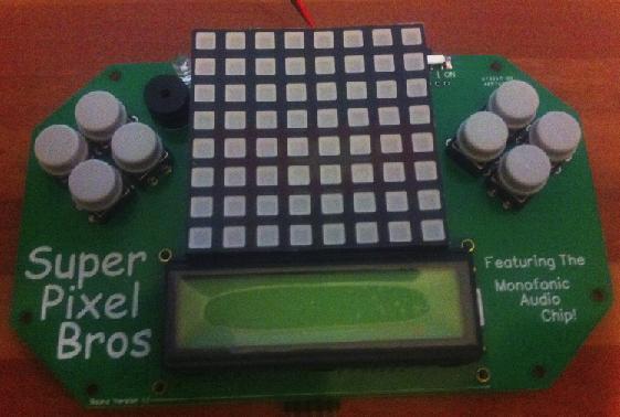

Hi people, I brought one of Brads great Super Pixel Bros PCB kits from itead studio and would just like to share how I put mine together.
The kit came with almost everything you need to build the Super Pixel Bros Kit, but I would recommend you buy a 8pin Dil socket for the MonoFonic Audio Chip and some normal header pins for the LCD display, examples below.

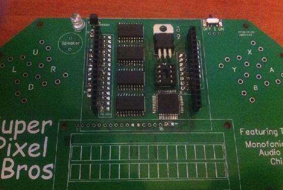

Can I just say that you need to be pretty good with a soldering iron to solder the surface mount chips on the board, So I started off with soldering just the surface mount resistors first, its a good idea to use a good soldering iron tip and flux.
Next I solder on the main chips (74373 and 18f4550) and the on and off switch, note this can also be pretty tricky, I recommend a small soldering iron tip with very little solder on the tip of the soldering iron.
Then next I solder on the pin headers for the LED matrix, 8pin dil, power led, transitor and our 5volt regulator.
Thats taken care of most of the tricky parts, next we solder on the buttons, 9volt battery lead and the buzzer.
And to finish it off we then need to solder the LCD display to the board with the header pins and then fix the LED matrix.

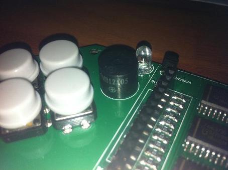

There didnt seem to be a Buzzer orientation mark on the PCB so here is a picture of the correct position for the Buzzer with the + symbol marked on the Buzzer:

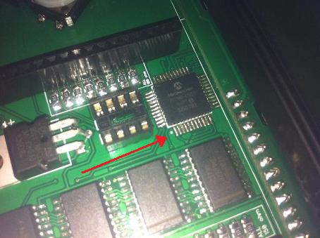

For the novice building this kit the position of the Microcontroller: Has you can see on the PCB there is a small white dot, which indicates Pin One of the microcontroller, this picture shows you the Orientation of the microcontroller, note that there is a small "dimple" on the microcontroller itself which should line up with the white dot on the PCB (the "dimple" on the microchip is abit hard to see in this picture):

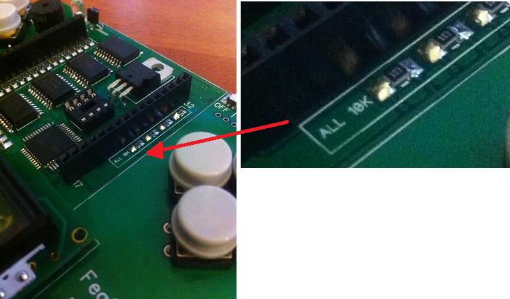

I wanted to also point out where the resistors go on the board: The kit comes with 3 different resistor values (150ohms, 1k, 10k) Brad has clearly shown on the PCB where the resistors go:

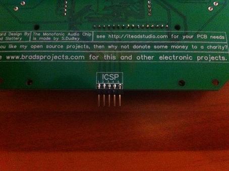

And for those who want to reprogramme the microcontroller in circuit, Brad has added some handy ICSP pads on the back of the board, I have added some Pin headers to mine like this:
