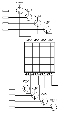

I.E. you would use say, PORTB for all inputs of all nine 74373's you would then need a further nine connections to use as the latch enable connections of the nine 74373's
Then you should be able to connect all of the 74373's output enable connections together and then to a single port pin.
since the 8x8 LED matrix displays are common anode you would need to use 24 NPN transistors to handle all the current (which would be upto 48 LED's on at any one time I.E. 24 red and 24 green on at the same time)
Here is an example of how you would connect the anodes to an NPN transistor:

Post by bitfogav » Sat Jul 24, 2010 5:07 am
Thanks Brad, that has giving me some ideas for a starting point, I know how many 74373's I might need and transistors now, Thank you :)
I was going use either a 40pin 16F877A or 18F4550 for this project.
Do you think using 24x 2N2222 transistors would be enough to power the 8x8 displays? (upto 48 LED's on at any one time I.E. 24 red and 24 green on at the same time)?.
I have also got swordfish downloaded and installed so will have to learn some pic basic then for this project. :)

Post by bitfogav » Thu Jul 29, 2010 6:56 am
Brad is this correct for a 24x24 led display in basic?
Const graphic_data(24) As LongWord = (%101110011100001110011101, %101000000000000000000101, %101000010000000010000101, %100001010000000010100001, %100000010000000010000001, %101000000000000000000101, %101000000000000000000101, %101000000001100000000101, %101000001000000100000101, %100000001000000100000001, %100000001100100100000001, %100000001001100100000001, %101000001100100100000101, %101000001010100100000101, %100000001000000100000001, %100000001000000100000001, %101000001000000100000101, %101000000000000000000101, %101000000000000000000101, %101011100000000001110101, %100000100000000001000001, %100010100000000001010001, %101110011100001110011101, %100000000000000000000001)
Const anodes(24) As Longword = (%000000000000000000000001,%000000000000000000000010,%000000000000000000000100,%000000000000000000001000,%000000000000000000010000,%000000000000000000100000,%000000000000000001000000,%000000000000000010000000,%000000000000000100000000,%
000000000000001000000000,%000000000000010000000000,%
000000000000100000000000,%000000000001000000000000,%
000000000010000000000000,%000000000100000000000000,%
000000001000000000000000,%000000010000000000000000,%
000000100000000000000000,%000001000000000000000000,%
000010000000000000000000,%000100000000000000000000,%
000100000000000000000000,%010000000000000000000000,%
10000000000000000000000)

Post by brad » Fri Jul 30, 2010 6:27 am
bitfogav wrote:Brad is this correct for a 24x24 led display in basic?
%000000000000001000000000,
%000000000000100000000000,
%000000000010000000000000,
%000000001000000000000000,
%000000100000000000000000,
%000010000000000000000000,
%001000000000000000000000,
%100000000000000000000000)
That code would work however it would not be very efficient due to the requirement to have 24 longwords (which is 24 x 32 bits = 768 bits or 96 bytes) Just to activate one column of LED's at a time.
