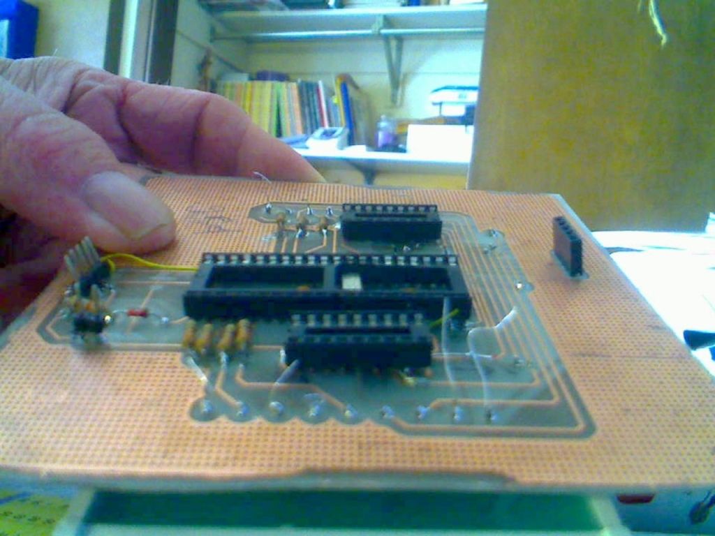

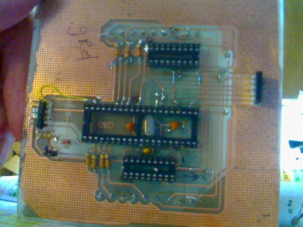

Here are some pics of the completed board. Note the crystal inside the 40 pin socket frame.
The 30G wires poking out of the board are a simple method to connect the top layer to the bottom layer on a 2x board. Much cheaper and easier than using automotive defrost repair glue or rivets. It works only if you remember to insert in all the right holes and solder one side to a trace. The 18 pin socket has several wires to tie top to bottom layers.
I was going to solder the 5x7 matrix to the board but made it removable in case I need to make changes.

The matrix connects to the bottom (opposite side from the PIC and ULN2803's. My problem is the pins on the matrix (wanted to be able to remove seeing how this is just for developing code only) won't contact the socket headers. Have encountered before so on to the soldering iron and a perfboard.

In the mean time, the matrix plugs into two headers located on the opposite side of the board (pictured) adjecent to the 18 pin sockets (note the 9 solder joints at each end of the board)

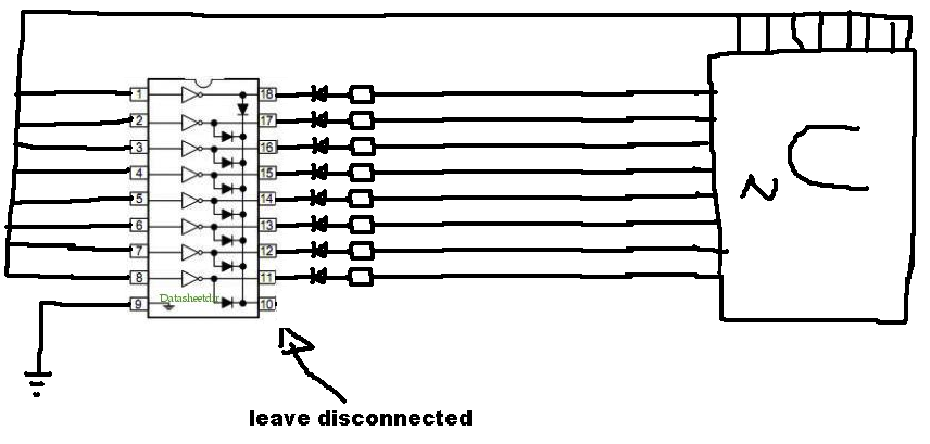

The issue I have found is I can't get the RD.0 pin to got high. I have yet to find any issues with wiring so hacking at the code just trying to configure the code so all the port pins go high. Using a ULN2803 to sink. Wondering why the LEDs seem not very bright? I started with 330 ohm resistors, put another in parallel but still not very bright. Could be an issue with the ULN2803 wiring?pin 9 grd and pin 10 Vcc.
Going to have another look at the data sheet. Keep thinking I need Vcc connected to the LED as well?
Re: Tetris on a PIC
Post by brad » Sun Sep 16, 2012 8:52 pm
Don't connect pin 10 - this simply places a diode in parallel with all your led / resistor combination (limiting the voltage across the two)
Connect them just like this:
