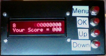

Post by brad » Sat Jun 19, 2010 11:48 pm
Today I sat down and wanted to see how long it would take me to make a very simple numbers game on one of those 2x16 LCD displays. All up from initial concept to the finished code was about 1 hour. I really couldn't tell you how long it would have taken me to code in assembly - but it would certainly have been ALOT longer!
I had already made up the LCD circuit with push buttons in a handy hobby box for another project I was working on, so all I needed was the code.

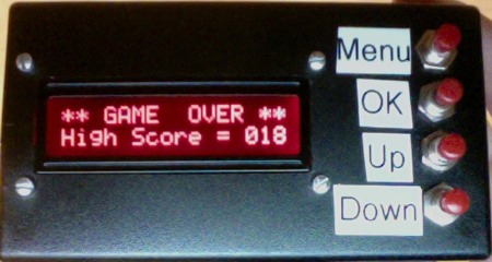

The game is very simple, you have a single digit at the top left of screen which can be any number between 0 and 9 inclusive. you can change this number by pressing either the up or down buttons. To the top right of screen is a random number (also between 0 and 9 inclusive) this number will scroll towards you (leaving a trail of the same number). You need to use the up/down arrows to change your number so that it matches the random number coming towards you.
If you match the number by the time it hits you, then you get a point. If you do not match it, then it is game over and the high score is displayed on the screen. You then press a button to play again.
Here's a couple of photos:
For those interested, here's the code:

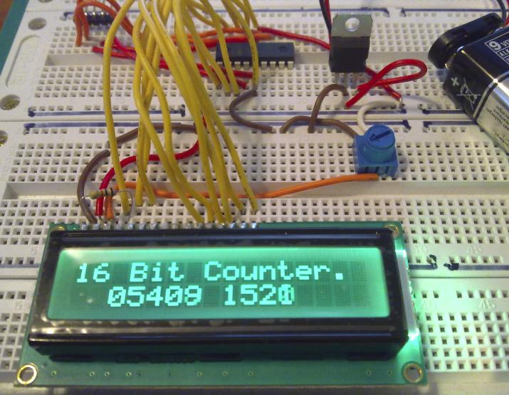

Post by bitfogav » Sun Jun 20, 2010 6:07 am
Wow that is a great idea for a project Brad :)
This is a 16bit counter on a LCD display I made up.
And heres the souce code to give people an example of how much different the programs are :D

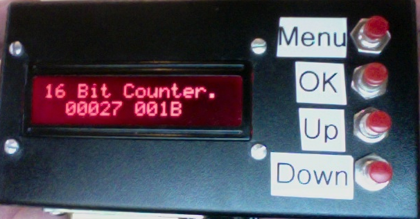

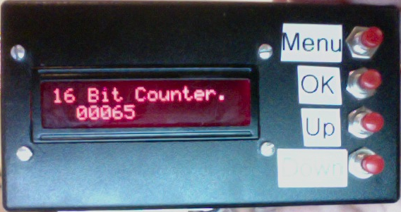

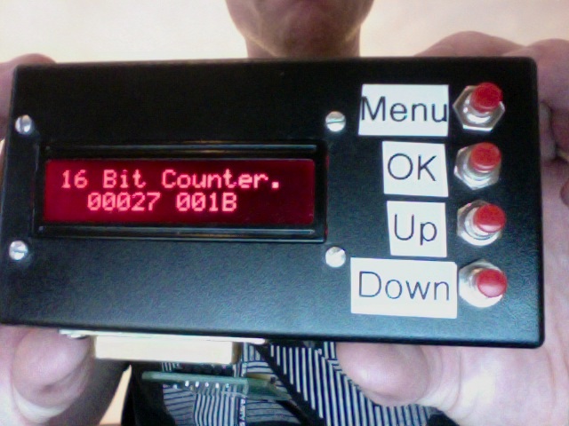

Post by brad » Sun Jun 20, 2010 8:52 am
Very nice indeed! Thanks for posting that.
i am not sure what those extra numbers to the right of screen are, but here is my version of the 16 bit counter, it just increments by one each second.
Here is the code:

// variable declaration
Dim counter as word
// Start Of Program...
OSCCON = %01111111                  // Sets the internal oscillator for 8Mhz
TRISD = %00000000                   // Makes PORTD all outputs except for pin 0
counter = 0                         // set the start point for the count
DelayMS(150)                     // Let the LCD warm up
While true
    LCD.WriteAt(1,1,"16 Bit Counter.")
    LCD.WriteAt(2,3,Convert.DecToStr(counter,5))
    delaymS(1000)
    inc(counter)
Wend
Post by bitfogav » Sun Jun 20, 2010 8:57 am
The numbers to the bottom right of the screen are the hexadecimal numbers.. :) they count up aswell as the 16bit counter
Post by brad » Sun Jun 20, 2010 9:00 am
bitfogav wrote:The numbers to the bottom right of the screen are the hexadecimal numbers.. :) they count up aswell as the 16bit counter
Here's my ammended code, I have added the line:
LCD.WriteAt(2,9,convert.hextostr(counter,4))
