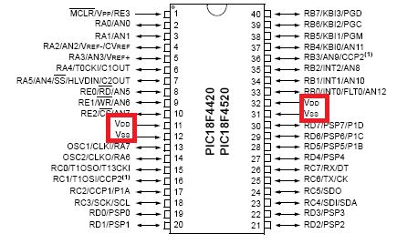

Why this microcontroller has 2× a Vdd and 2× Vss? Do I have to use both of these?

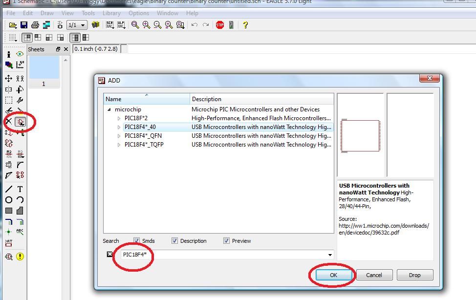

And how do I add a 74373 and a Pic 18F4520 in Eagle 5.9.0? I couldn't find these.

Good question!
My understanding is that they have two vdd and and two vss connections for two reasons. The first might be if you were using all I/O pins and drawing max current through them. If you then doubled the width of your power supply connections (by having two of them) then you should have no trouble drawing that much current.
OR
If that is not the case, then it could simply have two of each to make designing a PCB easier. for example you could be designing a PCB and you leave the VDD and VSS connections until last. One side of the chip may be cluttered with PCB tracks and would make it near impossible to get two more tracks to the VDD and VSS connections on that side of the chip.
This is where you can then use the other side of the chip.
You don't need to connect both of them - either side will do.

aliw - to draw a microchip 18f4520 in Eagle you need to click on the ADD icon and then type this into the search PIC18F4* then you will have to add a PIC18F4455 and then change the VALUE of the chip to 18F4520. :)

Thanks, but I still can't add this PIC :( take a look at this picture

Post by bitfogav » Wed Jun 09, 2010 6:37 am
Yes okay :)
Try this? open Eagle, you will need to click on 'Library' and then select 'Use' (this will open a seperate window)
Now enter microchip.lbr in file name and click on open.
Now click onto the ADD tab and type PIC18F4* and click OK..
thats it wow it works :D

Post by aliw » Wed Jun 09, 2010 11:35 pm
Thanks alot it worked! :D

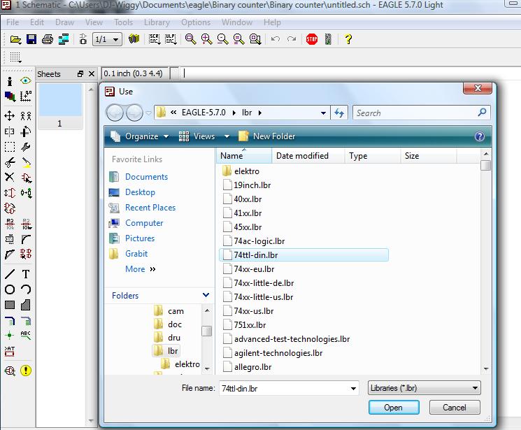

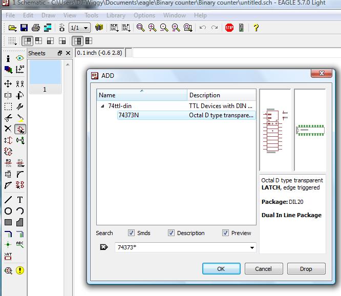

Heres how you can find a 74373 chip aswell :)
Go to LIBRARY again and click on 'USE' and then type this 74ttl-din.lbr into the file name and then CLICK on open.
Now go to the ADD icon and type 74373* and then it will come up like this :)
