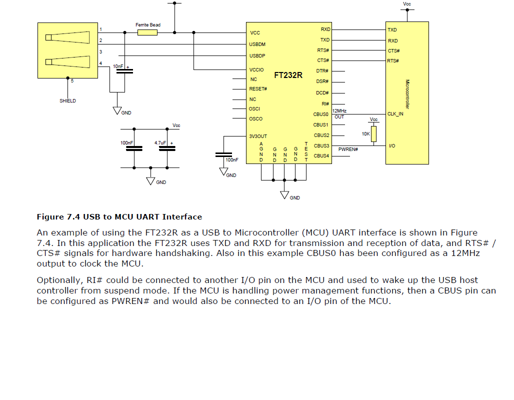

In process of researching how to program an Arduino so I cam across the FT232RL device but is there a better way to program. Was looking for a method to use the ICSP header but looks like its been tried but fails

I used that sort of circuit in my PICnDuino
Perhaps you could have a look at Bitfogavs board, it might help you on your way.
Otherwise, if you wanted to go Arduino at all, the leonardo version doesn't need any sort of usb to serial conversion, it does it all in the one microcontroller

The Adrunio board is in addition to the basic development board's. The Adrunio is a daughter board that plugs into my Board 1 w/ a 40 pin socket etc. then the Adrunio can access all the options on boards 1, 2, and 3. I want to keep it as simple as possible but it's getting out of hand with an LCD, 8 x 8 matrix and keyboard options.

It looks like the USB to serial board that Sparkfun has for $14.95 is my best choice All I need to do is have a section to solder two 9 pin headers then let the hobbiest purchase the usb / serial board.
