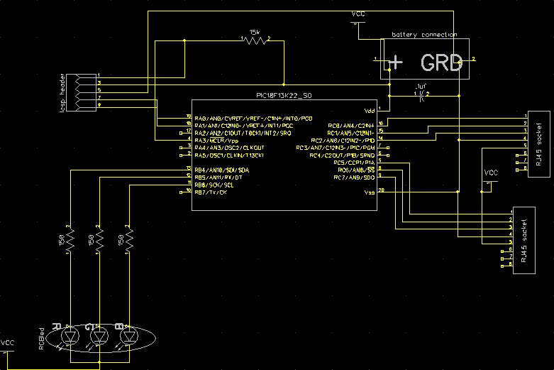

Here is the simplistic schematic. The two other candles plug into the the RJ45 sockets.
Even contemplating adding or eliminating an on/ off switch to save cost.

One thing to note - you have your cathodes connected to Vcc, those will need to be going to Ground (Vss)

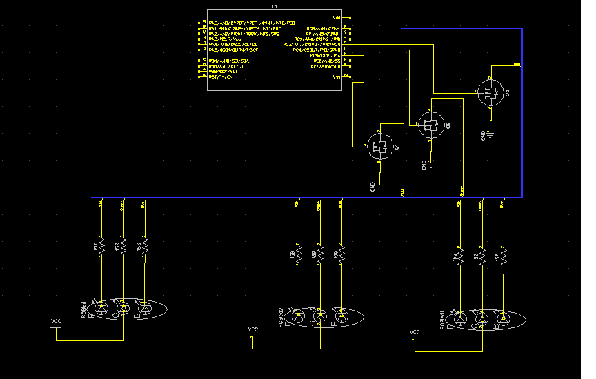

I realized that I had the LEDs wired backwards after I posted.
BAD NEWS -- the PWM outputs on the 2420 there is only tweo. The results of the code I posted looks more like a strobe light than a candle. Attempting to slow it down but no go so far.
GOOD NEWS --- the 18F13K22 I planed on using has 4 PWM outputs (pins 5, 6, 7, 14) and thinking perhaps a PWM output would simulate a candle flicker better.
here is what I am looking at doing. Now to actually start using the 18F13K22 I just got in the mail, figure out how to implement the PWM module in SWORDFISH.
any suggestions welcomed.
