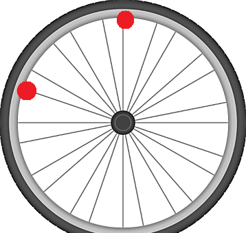

Just has an idea..
Because the bike wheel will be variable rotation, you could use two pickups on two different spokes?, and use an interrupt and timer to calculate the time between the two pickups.
You could then calculate the speed of the wheel and if you wanted to set an average over time, and use that to trigger the graphics over a set time base (so that the graphics is spread out equally), and to align with the wheel speed.
The one pickup then could be used after you have a wheel speed caculation to trigger the starting point for the POV image.
Picture below to show what I mean by the position of the two pickups: But on the other hand you could just use one pickup on the bike wheel and use a timer to calculate one rotation of the wheel and work out the wheel speed and at what speed the POV needs to be set at to draw the image.
So the main problem is the variable wheel speed, I'm sure at very slow speeds the POV isn't going to work correctly anyway!.

You right Gav, you will certainly need to calculate how many revolutions per second the wheel is doing and then use that to trigger the interrupt to draw the graphics at the right time.
You will also need to be riding at quite a great deal of knots to make sure that you don't get flicker on the display - I have seen others get around this problem by adding extra LED strips, the monkeylectric version I think has four strips so each strip takes care of drawing 1/4 of the complete display (instead of 1 strip trying to do the whole 360 degree rotation.
