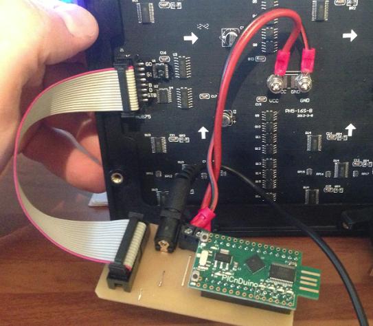

I got the same 32x32 RGB display has Brad, And running it with a PicNDuino ment using lots of wires to control the display and it just looked untidy and not only that I wanted something where I could easily disconnect and assemble the display quickly, because connecting each wire from pin to pin surely takes awhile!. :lol:
So I've made a DIY pcb Convertor for the Display and PicNDuino board!..
Also while designing the board I wanted a way of powering up the PicNDuino from the same power supply as what is used to power up the Display, so the power line is connected to the 5v rail on the PicNDuino (note: that I'm using a Mains Regulated 5v power supply - so not to burn out the PicNDuino board). So if I wanted to hang the display somewhere, then it means I only needed to connect the power supply to the board and everything runs nicely..
Programming the PicNDuino is still easily done by connecting the USB to the PicNDuino, ive had no problems there..

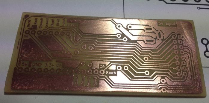

Heres the pcb board after etching - its not perfect and one small repair had to be made to one trace.

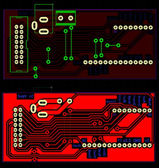

Top and Bottom view of the Diptrace pcb design.
Sorry I dont have a schematics, everything was just done by manual routing in Diptrace..
Everything connected up to the display

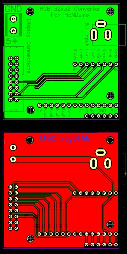

I thought about this too!, in fact I might be able to fit it all in a 5cm X 5cm board if I use both layers! :)

Well here it is!!.. a 5cmX5cm PicNDuino Converter Board for the RGB Display :lol:
