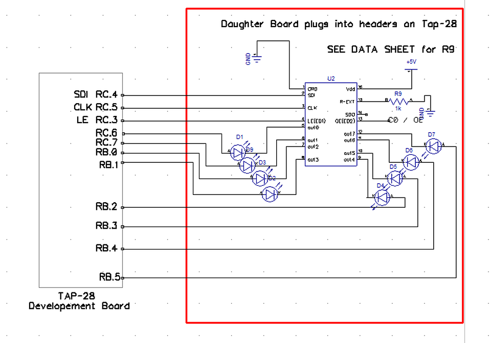

Eliminated a-lot of fluff so I can be "AT ONE" with this interesting chip. It sure makes a difference as far as led brightness and all the same intensity.
Using 8 leds to indicate what is happening inside the chip. In the simple schematic I failed to use pull ups on the SDI and CLOCK lines. seems to work without but probally a good practice to include.
*EDITED by bitfogav - adjusted image*

Using the posted schematic, the LEDs are drawing 18.9ma each but they seem really bright. WHY? your guess is just as good as mine. Maybe just imagining.
Re: Experimenting w/ TLC5916/17
Post by bitfogav » Sat Nov 17, 2012 9:38 pm
Just because it is recommended that the max of 20mA is used to operate a LED doesn't mean you have to run them at 20mA?, adjusting your Ext resistor to an higher value will adjust the brightness of the LED's..
Sometimes its about personal preference and I quite often use an higher value resistor to run my LED's at 10mA which usually give good results. But for the 8x8 matrix's that what Brad uses in his projects its always a good idea to use a lower value resistor especially when its driving several LED's at the same time..
Post by brad » Sun Nov 18, 2012 6:52 am
What is your battery voltage? because if you are getting 18.9mA through a 1K resistor that's 18.9 Volts!

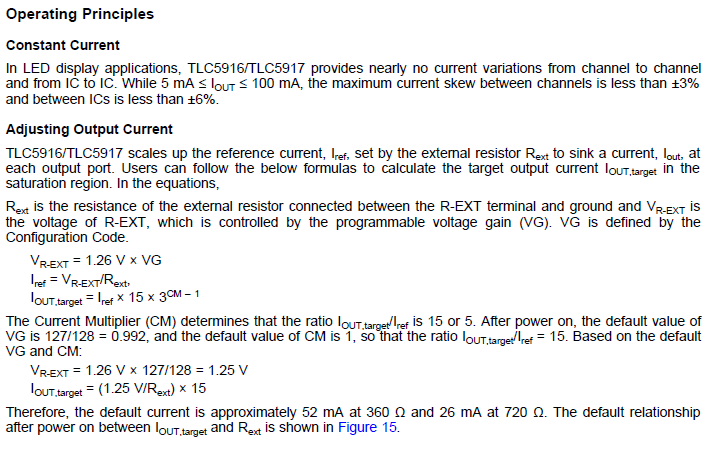

The 1k resistor is the external resistor that sets the current for each led. 16 channels = one resistor, 8 channels = 1 resistor.
here is screen shot of app note. This cuts down on part count and equalizes the LED intensity. There is a dot correction available as well.
Being the last person to ask about algebra I looked at the data sheet then decided on 1k seeing how a 720ohm = 26ma if I recall. Used the 1k and actually measured the current draw at 18.9ma. Contemplated using a 1k pot to find out EXACTLY but I haave a hunch the external resistor is involved on power up so one might not be able to change while the chip is powered. I might be wrong but thats the impression I get reading the data sheet.
Post by brad » Tue Nov 20, 2012 9:18 pm
Oh I get it - it's a programming resistor!
