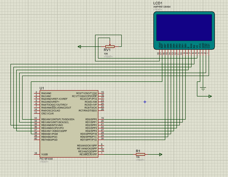

my schematic on proteus
(13.77 KiB) Downloaded 979 times

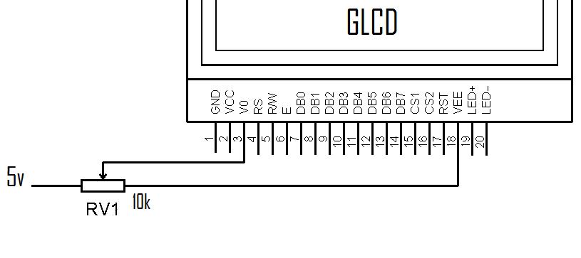

Hi captalex, Im not familiar with mikroC, but looking at your test code, aren't you missing the GLCD librarys Or Headers? and dont you have to include the header file for which microchip you are using?, also I cant test your schematics as I dont have proteus :(
And as for your display backlight not working, all Ive done on mine is connect it up as this, im using a 10k potentiometer going to my 5volt supply and then the other two connections connect directly to the GLCD pin 3 and 18, this is to control the contrast of the display, you also need to connect pins 19 to 5+ and pin 20 to ground to operate the backlight.
GLCD Pot connections.jpg (27.54 KiB) Viewed 28264 times

Post by brad » Mon May 23, 2011 6:12 am
Perhaps you could open up your schematic in proteus and take a screenshot for us?
odessa
Posts: 102
Location: London
Re: Microcontroller based Graphical lcd game
Post by odessa » Mon May 23, 2011 7:09 am
Thats the schematic Brad
If you upload the Hex file I can test it for you in Isis Captalex

Hi,
The errors I get on Isis running that code suggest you haven't defined the processor properly
Have you selected it project settings ?
Also when using using GLCD's in mikroC, the lower the clock speed the better, its glitchy.

odessa wrote:Hi,
yes odessa, i have selected the p18f4550 device in the project setup and also set the clock speed to 4mhz, i use mikroC
v 8.2 and so some of the glcd routineslike "Glcd_Init()" are different from the ones on mikro c pro v4.6. what do you suggest i do ?

Hi,
My version of Isis doesn't have the 18f4550, where did you get yours from ? I ask as when I use your design nothing will run at all.
If I delete your 18f4550 and use the 18f4520 in Isis everything runs fine.
I dont use Mikro C, I'm borrowing someone elses to test your code which lists 1000's of error as it runs lol.

I have tested that using an identical schematic to yours but with the 18f4520 in Isis and it runs perfectly
I think your problem is with the processor model and your C code
Also in Isis you dont need to connect anything to Vo or -Vout on the GLCD for it to work

about the 1000 errors :
i fixed them, i rewrote the code again and now my glcd can display both text and some cool 8bit graphics!
but for the image i converted my image to an array stored it in a .c file , added it to my c source files in the project setup and called it in my program but it doesnt seem to be able to access the image.
eva.rar

Post by odessa » Tue May 24, 2011 4:54 pm
Hi,
It works fine in the test code using your Bitmap instead of the truck
There isn't anything in the code you posted there to draw the bitmap
Jay
