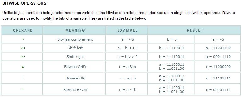

PORTB |=
PORTB &= ~
The code that you pointed out Jay are bitwise operators in C as all I wanted to do was change bit0 of PORTB, the diagram below might help explain the bitwise operators in C better.
The one bitwise operator that confused me when I saw it was "~" bitwise operator but once you understand how it works its easy enough. The "~" is a bitwise complement (bitwise NOT), in other words this operator works like this:
So if we take the binary value 1.
00000001
Then if we ~1 using the "~" operator, this will flip the bits so the value is now.
11111110
Hope that helps you understand how the "~" operator works. the others which are "&" is a bitwise AND, and the "|" is bitwise OR operator.
