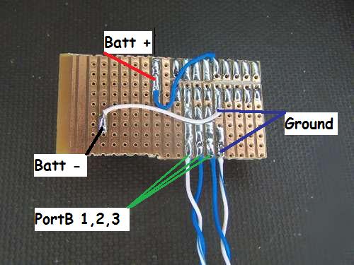

Hello Brad! :)
Would you mind to post the schematic for this project?
:D http://www.instructables.com/id/The-nig ... /?ALLSTEPS
thank you very much!
marC:)
Re: flashing rainbow schematic, instructables?
Post by brad » Tue Apr 17, 2012 6:08 am
I didn't have a schematic for it but it's quite simple - the LED just connects the three anodes to PORTB 1, 2 and 3 (each one through their own resistor of about 150 ohms) then the cathode of the led goes to ground. Thats it!
Post by bitfogav » Tue Apr 17, 2012 10:35 pm
Looks simple to me, I would say use 100ohm resistors if your using a 3volt battery :)
