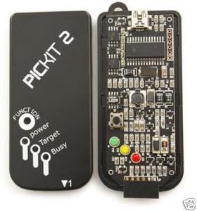

The reason I asked if you had a clone pickit2 was because i know they give some problems with programming chips, Heres a picture of a Clone pickit2

No, I do not have a clone pickit then. Mine looks like the official one does. (With the red two and Microchip written on top.)

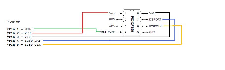

I checked your diagram and that is exactly how I have mine wired up, so that isn't the problem.

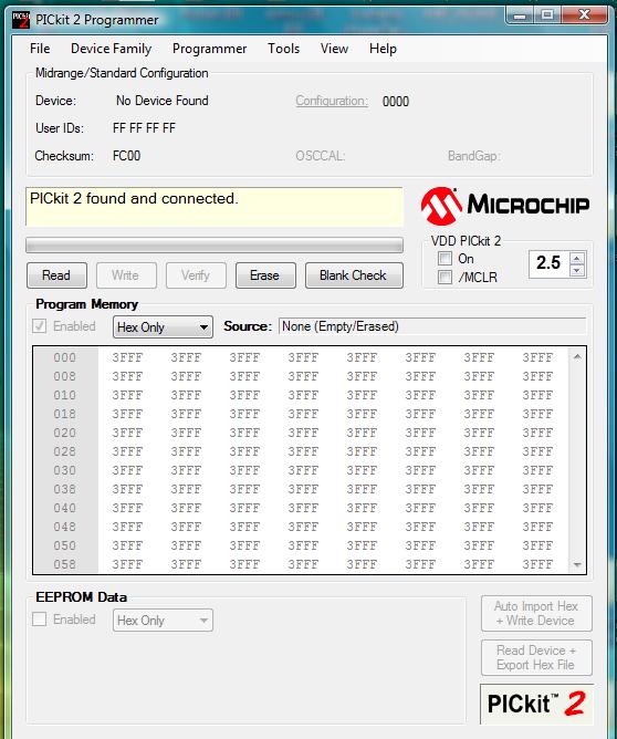

Thats answered my next question, I would try using the pickit2 software instead of the MPLAB IDE
If you need to download it then you will find it here, near the bottom of the page, under "Windows Software & Firmware"

Jumbosize did you try the pickit software I suggested above? it works better that using MPLAB to programme microchips.
you need to download "PICkit 2 V2.61 Install" and you might need to update your pickit2 firmware.

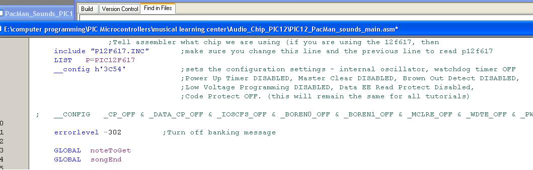

I am really surprised that no one has mentioned (or asked) if Jumbosize changed the processor in the include directive, or even bothered changing the configuration settings to match the new processor?
The above should read:
include "P12F629.INC"
LIST P=PIC12F629
__config h'xxx'
The config settings should be set how you want the processor to work. For example, do you want to use the internal oscillator, disable the master clear, allow for low voltage programming, etc. This information is found on page 54 of the PIC12F629 data sheet.
LIST P=PIC12F629
__config h'xxx'
