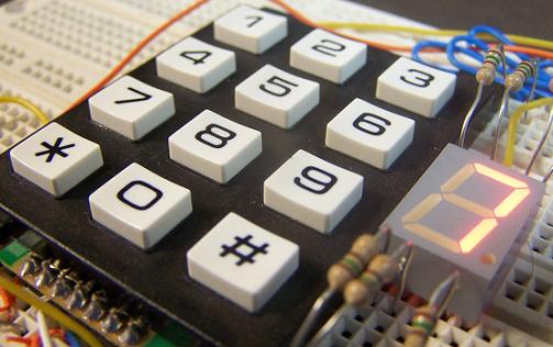

Okay so first up, let's get some background on how the keypad works:

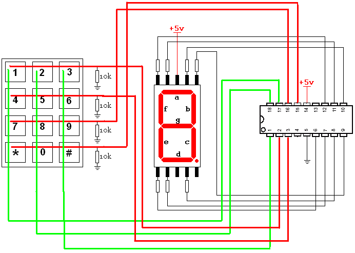

You can see in the image above, that each of the 12 keys are multiplexed. that means that there arent simply 24 outputs (I.E. two connections for each button) but they are connected together in rows and columns (4 rows and 3 columns)
So to get this thing to work we have to add a few resistors and then program a unique piece of code to 'scan' the keypad. This is how we are going to connect the keypad to our existing seven segment display circuit:
So this is how it will work. Our four rows are all connected to ground through the 10k resistors. So our four inputs to the microcontroller namely - PORTA pin 3 PORTA pin4 PORTA pin 7 and PORTA pin 6, will all have logic zero's on their inputs.
When we start the scan routine (which you will soon see in the sourcecode) we want to check one column at a time and check if any of the four buttons in the column has been pressed. If one has been pressed then we will copy that number into the working (w) register for use after the scan is completed. if NO key has been pressed then we don't copy anything into the w register and we just keep scanning the keypad. So what do i mean by scan the keypad?
Well download this sourcecode and have a look at what is happening:
http://www.bradsprojects.com/phpBB2/upl ... ce_151.asm
We start the scan by sending a logic 1 to PORTA pin 0 - this means that the entire left hand column of the keypad has a logic one waiting on one side of each key. now the other sides of all keys are connected to ground through the resistors. If we then press key 1 at this stage, then we have now placed a logic 1 (+5v) ontop of the top row resistor, this means that the resistor is now dropping +5v and since PORTA pin 3 is connected to the top of the resistor, we now have a logic one on PORTA pin 3. so we have now sensed that key 1 has been pressed and at this point - we would copy decimal 01 into the working register.
once we have scanned all four buttons in the first column, we then send a logic 0 to PORTA pin 0 because we are no longer scanning it anymore. We then want to scan the middle column - so we send a logic 1 to PORTA pin 1. Now we repeat exactly the same process - does PORTA pin 3 have a logic 1? if yes then key 2 has been pressed but if not the check to see if we have a logic 1 on PORTA pin 4 - if we do then key 5 has been pressed and so on...
The sourcecode for scanning the keypad should be quite straight forward and hopefully you can see the need for doing it this way.
Once we have scanned the entire 12-keys, what ever number that we copied into the w register, we will now copy that for use a little later into 'what_button' variable. We will use this number to tell the program what number to display on the seven segment display. now we have finished the scan routine - we return to the main routine.

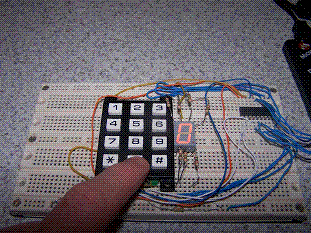

Here is a neat little animation of the what happens when you press each key on the keypad:
