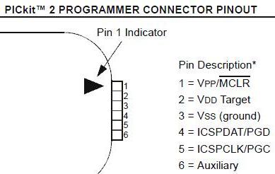

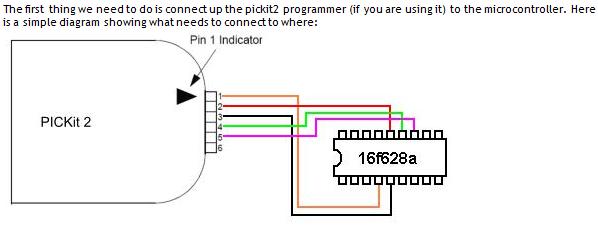

When programming the microchip all you need connected is your power, ground, your two data lines and MCLR pin.. so yes for testing you can just connect your programmer to the microchip.. check out the picture below if you need help connecting up the programmer.

- pickit2 how.jpg (15.96 KiB) Viewed 26950 times
- pickit2.jpg (19.91 KiB) Viewed 26956 times

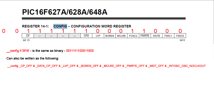

One note about the _config h'3f18'
Microcontrollers have many different registers to configure the different functions (i.e. STATUS register, OPTION register, INTCON register, and all kinds of crazy registers). These are things you will definitely want to read up on as you progress. Once you understand how to set up one register, it will be much easier to read the data sheet and understand how to set up each register to do what you want (such as your timers and interrupts).
This is what sets microcontrollers apart from microprocessors, in that you can configure them for different individual tasks then go back and change that anytime you want.
So...
The “configuration” register in a PIC deals with the special features such as setting code protection, power up, brown out, low voltage programming, setting the type of oscillator you want to use, etc.
Don't worry about any of this stuff for now but I just wanted to mention this because as you start experimenting more you will want to venture out to new PIC's and will need to know how to configure them.
Page 97 in the PIC16F648A data sheet explains a little about this and page 98 shows the different ways to configure the PIC16F648A.
Look at the following picture and read through page 98 in the PIC16F648A data sheet and hopefully this will help give you a visual understanding about what __config'3f18' does to the CONFIG register.
Each PIC will be configured slightly different so h'3f18' will not work every time. Also, you may want to experiment later with an external oscillator and this will need to change.
I hope this helps a little.

- PIC-configuration.gif (14.15 KiB) Viewed 26919 times

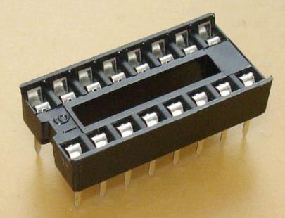

Glad you got it all working now I have learnt so many things jus doing things myself and I have also damaged one or two microchips when I started off by heating up the microchip too much with a soldering iron, I did go out and buy a soldering iron with a smaller wattage and heat range and one other thing I do now with some of my projects is use a IC socket, (check picture) this way your not applying any heat to the microchip at all and if you need to change the microchip at all then its easier to remove it
Static can also be an issue too, I havn't had many problems with static apart from once where one of my projects was handled by someone and im not sure if it was something they touched on the board but it totally messed up the microchip, even the pickit2 wouldnt read it hehe! Luckily it was just a case of programming another microchip and fitting it.
- ic socket.jpg (17.68 KiB) Viewed 26886 times

Thats a brilliant idea Gavin... I am going to order one right now. I think I've managed to break another one as well... Its strange everything was working great I had reprogrammed it heaps of times and then I tried to reprogram it once again however it started coming back with an incorrect ID for a PIC16F648A error (was coming back with and id of 0x3000 or similar). I went over my board with a multi meter and found that a solder joint was just managing to short out pins 12 and 13 which are the programming data and the programming clock. Pretty sure there are no more shorts however cannot get the chip out of this incorrect ID state. I guess it still could be other issues with the circuit as my soldering does leave a bit to the imagination however I can't see having those two pins shorted out would have done good things to the microcontroller either. In any case going to start from scratch and get some more practice soldering. Good thing these 16F648As are as cheap as chips.one other thing I do now with some of my projects is use a IC socket,.

I always try and use a DIP socket (as Gavin posted) when I build my circuits for the same problems you are having.
