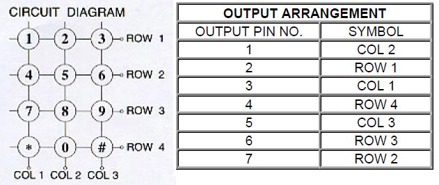

Hi! I have bought this keypad : http://www.abra-electronics.com/product ... rrencyId=2
it got 8 pins, i cannot find the datasheet, someone can help me with these pins according to brad tutorial?
thanks a bunch!
marC:)
Re: Tutorial 6 - Help with interfacing a keypad
Post by brad » Sun Jul 01, 2012 5:21 pm
I just did a google search for keypad pinout and it had this image. It could be what you need.
(Image from http://talkingelectronics.com/pay/PIC/PIC-Page21.html)

brad wrote:I just did a google search for keypad pinout and it had this image. It could be what you need.
thank you so much brad! i will let you know how it goes :)
