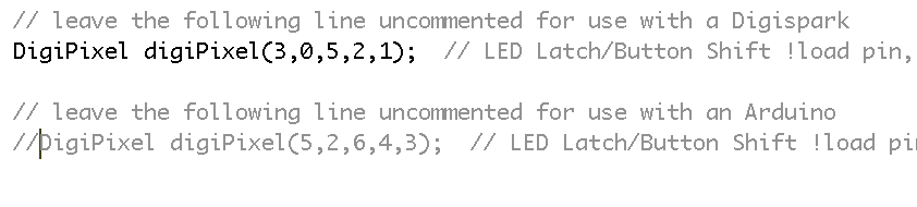

have you made sure to comment out the arduino specific code and then uncomment the digispark code?
Screen Shot 2015-10-09 at 3.37.09 PM.png (14.03 KiB) Viewed 32472 times

Yes yes, that is also correct. Does the digispark need any special attention before playing with this?
