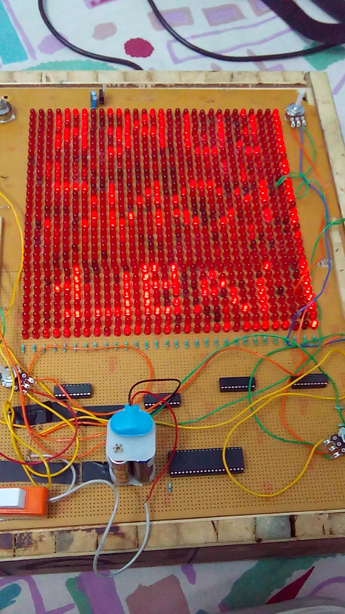

So i followed all the instructions and made my own super pong table. But when i started it, it didn't really do much.
It showed the title Super Pong Table as a mirror image. Also it was a little bit moved towards a corner.
In few initial startups it showed choose your player screen. But now it doesn't even show that.
The main problem is that the two buttons for mode and player selection do not work. They seem to show no effect on the game.
But in-spite of all this sometimes the game starts randomly.
I don't know where i have made a mistake.
I have checked all the circuit for any loose connection or any mistake as per the schematic you have given.

Hey brad, sorry to replying late. This is the project i made, i've attached the pics. I didn't have the pcb so i have wired all the connections. The mode button is not working, display is mirrored and one line is behaving like a permanent wall. Moreover upon turning on the circuit, random things are happening, i.e. like shows the "super pong table" or player select or the game, but all randomly. I have done exactly as given on instructables, please tell me if there is something there.
please see the attachments.
link to video, when powered on, mode buttons not working here
please help, this project is already selected for display in the university.

Hmm, firstly by looking at the video, you will need to rewire your less so that it is not back to front. You will just need to swap the left most connection with the right most connection, then the second left most connection with the second right most etc. Keep doing this until all 30 have been re-wired.
As for the screen having a solid line and also what appears to be some ghosting (for example, down the bottom of the screen). This would be caused by either faulty wiring / soldering (I.E. you may have shorting a cathode to an anode somewhere) or you may have a faulty LED or maybe a few. I have had this sort of ghosting problem before when making my own matrix displays and it is always down to one of those two problems.
Now as for the screen displaying random things (sometimes the super ping title, sometimes the game etc. This is because the buttons are not connected to where they should be. Unfortunately I messed up the code on my latest instructables upload. Did you have a chance to have a read through the link I posted above? that link tells you where the buttons actually need to connect to.
