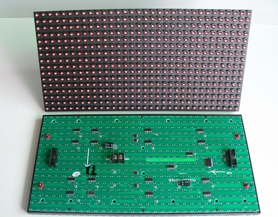

I have found a much better way of making the display - and that is to not make it at all, just buy it!
You can get a 16x32 pixel RED LED display for $10 each here: (postage is a little expensive though. two boards + postage = $57)
http://www.aliexpress.com/store/703830/ ... e-P10.html
You are thinking right up my alley with tetris. I already have though about an RGB version which would be an all in one game table. You could play super pong + mario bros + other games aswell - all in 3-bit color!
