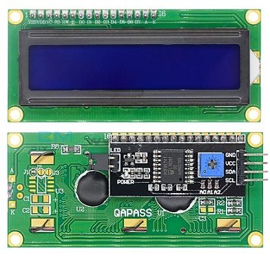

I just wanted to share that I have added a new module for Swordfish so you can now use the cheap LCD displays with the I2C PCF8574 chip boards :D

That looks nice. Do you sell the I²C module? I don't see any way to buy it. Actually, I'm sure it could be used for a lot of other things besides an LCD, right? And there are undoubtedly a lot of I²C-to-parallel adapter ICs on the market, probably from Maxim and others; but this one is already made up on a little board with the trimmer for the viewing angle too. I didn't see a voltage. Is it 5V? I think most LCDs still are 5V, but I have not been paying much attention in recent years. Is there a data sheet? [Edit: Never mind. I found the PCF8574 data sheet, at https://www.nxp.com/docs/en/data-sheet/ ... F8574A.pdf.] Your sample code is very neatly formatted, but it's not a language I'm familiar with. I've used LCDs based on the Hitachi controller many times since 1986 (I like that it's so stable; very few things are made for so many decades, just working and working!), and I have my own code in 6502 assembly and in Forth, as well as I²C driver code, so if I can see just the few details of what the board needs to make the conversion, I'm all set. I would like to add it to the displays page of my 6502 primer, at http://wilsonminesco.com/6502primer/displays.html, if my visitors can buy it.

No I don't actually sell the I2C module or LCD, for me here in the UK they are widely spread around sale websites, Amazon, Ebay etc..
But you can get a HD44780 LCD and PCF8574 breakout board separately and bind them together, which is basically all these are..

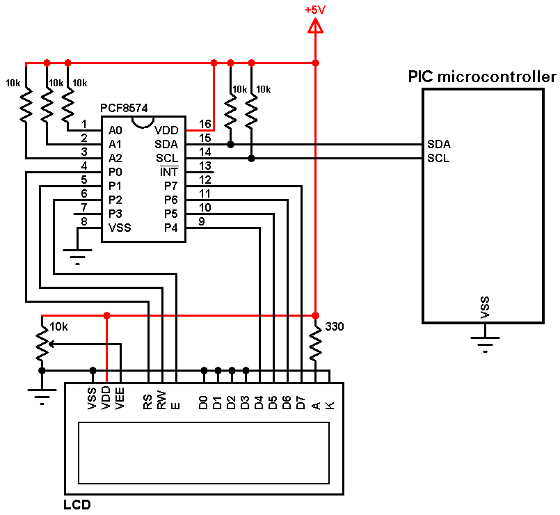

The PCF8574 is just a I2C to Parallel-Port Expander chip. You only have 7 pins on the PCF8574 connected to the LCD pins, This is all you need, as we setup the LCD in 4bit mode, and control the LCD control lines via the other 3 pins from the PCF8574.
When you send data to the LCD via the PCF8574 you have to take into consideration the RS,EN and E pins, and make changes to the data byte that you send, which involve a lot of bitwise logic.

If its any help then this is how the PCF8574 is wired to the LCD display, if there is anything I can help with then Ill try my best.

I was thinking late last night and I forgot to mention the LCD backlight control. I know I said the PCF8574 only uses 7 pins, that's not totally true. I forgot to mention PCF8574 P3 is actually the LCD backlight control.. So I stand corrected, the PCF8574 uses all 8 pins to control the LCD. So the schematics above isn't totally correct. That will teach me for searching on google for the schematics and assume its correct. :oops:
