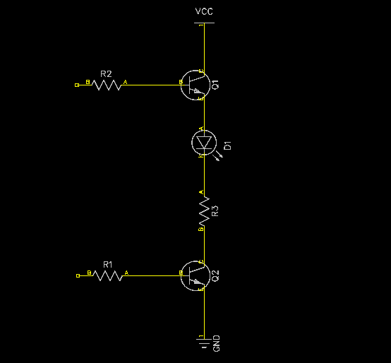

And now that I have all the information, you don't actually need to invert any data at all. Wire up your matrix so that one transistor takes care of connecting the anode to VCC and the other transistor takes care of connecting the cathode to GND (through a current limiting resistor maybe 100 ohms will do)
Resistors R1 and R2 need to be low enough such that they will place the transistors into saturation when a logic 1 appears on them (from the microcontroller) 1K will be fine for this
As for drawing your graphics / scanning through the matrix (based on an 8x8 matrix with PORTD driving the cathodes and PORTB driving the anodes)
Sub DrawGraphics()
for x = 0 to 7
portb = GraphicData(x)  'sends all eight bits of graphic data to PORTB (but wont be turned on yet)
portd.bits(x) = 1 'now we activate the certain column of cathodes
delayms(10) 'delay for whatever you think is good
portd.bits(x) = 0 ' now turn off that column of cathodes)
next
End Sub

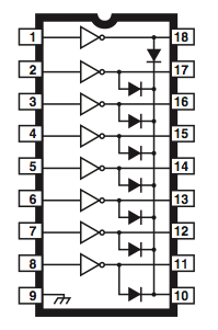

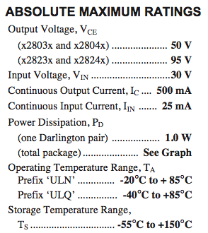

A question - transistors are great, though they can chew precious PCB space very quickly (also require a base resistor). If your using 16x25mA LEDs; perhaps two ULN2003s would be appropriate? They are quite cheap and take up very little space (could even use the SMT versions if you wanted). Well within the current rating that your working with :wink:
Re: PIC TETRIS/inverting pulses
Post by brad » Fri Jan 28, 2011 9:37 pm
Actually that's a good idea to go with those chips.
The only one thing I don't like about them is that they only have seven inputs / outputs. eight would have been perfect!

My bad, I was supposed to link the ULN2803A
:roll:
Post by brad » Sat Jan 29, 2011 6:48 am
Mitchy wrote:My bad, I was supposed to link the ULN2803A
:roll:
Now we're talking!
I bought a whole load of these on ebay and I think they cost around 20c a piece, which was a fantastic deal.
And check out the specs :D
