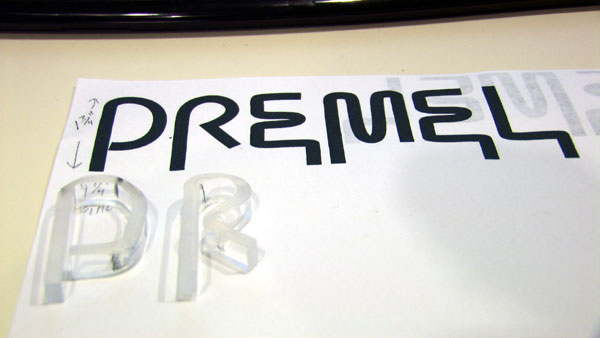

I was experimenting a little tonight and came up with a design for the letters. Below is a picture of how I plan to make them work. There is a protruding part of the letter which will sit into the base to hold it up and the LED will sit under that and in turn light up the letter. You can see the two letters I was experimenting with tonight.
Forgive me for the horrible pictures. I just grabbed the camera and shot so I could post this.

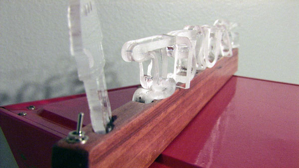

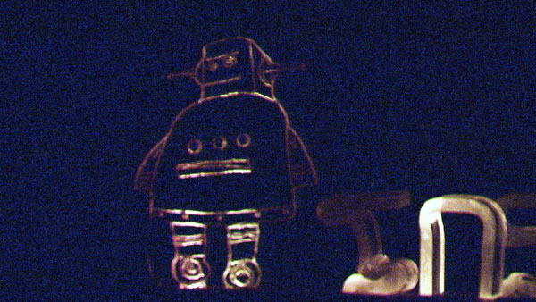

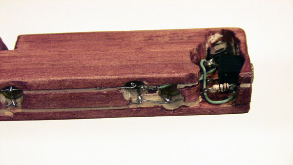

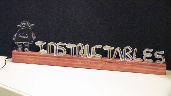

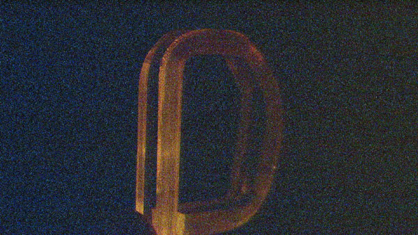

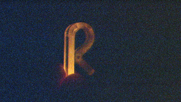

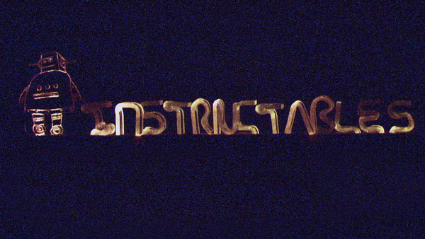

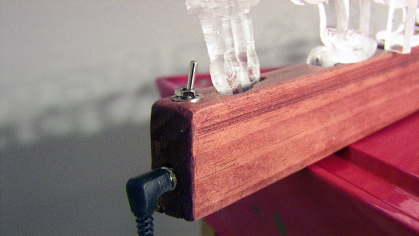

I had planned to post an instructable on making the 3D edge lit letters but it didn't turn out as well as I had hoped. The LED's are not very bright LED's, which are needed for this type of project. Also, the bends in the letters really take a toll on how well the light makes it's way through the acrylic. Notice the I, S and E get pretty dull after the sharp bends.
The wood and acrylic were cut, routed, shaped, and sanded using the mini-tablesaw I made.
Here are a few pictures showing the end result. It makes a nice night light as long as it's very dark in the room.
I did end up winning a Dremel (very cool) and got a runner up with the same project in another contest. All-in-all I'd say I made out pretty well.

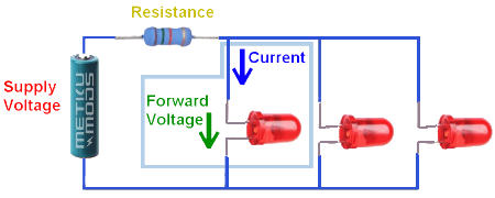

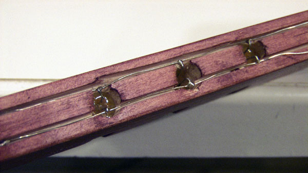

How have you got the LED's connected? All in parallel and then in series with a resistor?
Congrats again on winning the dremel contest and also for coming runner up in the other.
- sdudley
- Moderator
- Posts: 337
- Joined: Sun Mar 28, 2010 1:33 pm
- Location: Florida, U.S.A. [phpBB Debug] PHP Warning: in file [ROOT]/vendor/twig/twig/lib/Twig/Extension/Core.php on line 1266: count(): Parameter must be an array or an object that implements Countable
Re: Something for your Dremel...
Yesbrad wrote:How have you got the LED's connected? All in parallel and then in series with a resistor?
