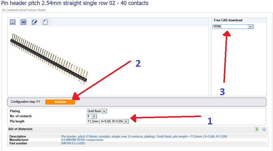

I have found a website 3DContentCentral.com it is a website which as Free 2D and 3D CAD Models of User-Contributed and Supplier-Certified Parts. But you will have to register to the website to download the files. Use the search box to search for your required part/component, Once you have found the part/component that you require: For an example Pin header you will need to select the number of contacts (pins) you require etc and then click the "Validate" box to update the component for download, then select the file type from the drop down box under "Free CAD download" this is IMPORTANT you must make sure that the correct file type is selected, you want to select the "VRML" file type, then click download.. The image below shows the steps required for download..

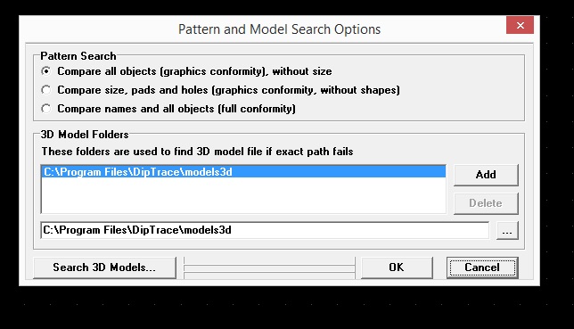

Now in Diptrace you need to Import (refresh) the 3D folder so that Diptrace finds the new component/components.

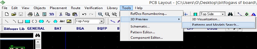

Tools > 3D Preview > Patterns and Models Search
Dialog box will open - All you need to do is click "OK" that is it! - the new component/components will be imported

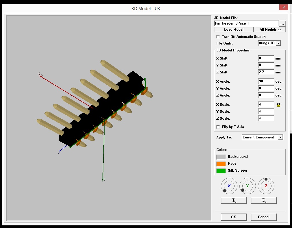

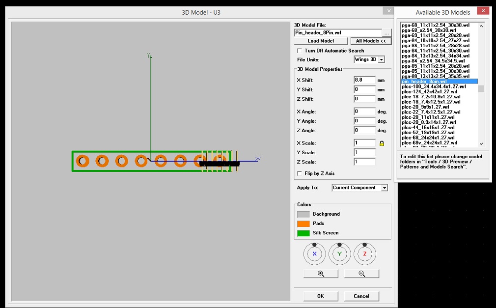

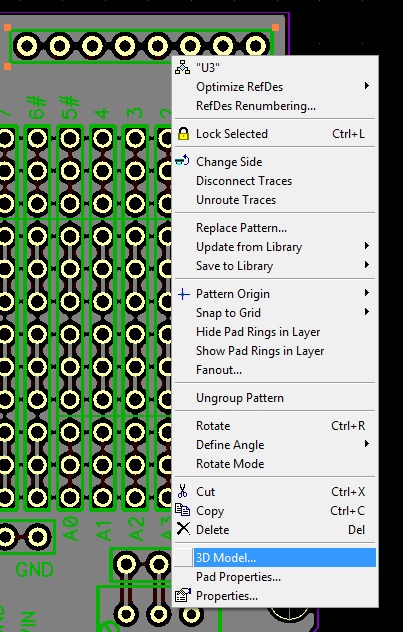

On your Diptrace design, select the part which you wish to update the 3D component for (right mouse click), and select 3D Model..
Find the imported component by clicking the "All Models" box, search down the list for the named component. (in my case the 8pin header).
Now this is the HARD part:
You need to adjust the component SIZE, X/Y/Z Shift, X/Y/Z Angle. The only way I can figure this out is by playing around with different values and checking what the component is doing in relation to the pattern outline.
You can move the pattern around inside the 3D pattern window, so you can see it more clearly.
As you can see from the image below, the component is now aligned correct to the pcb pattern.
Just click "OK" and the component/pattern will be added to the pcb design.

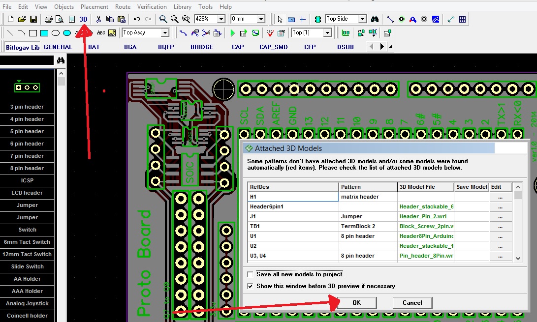

Now open the 3D pattern for your design, just click "OK" with the following box:

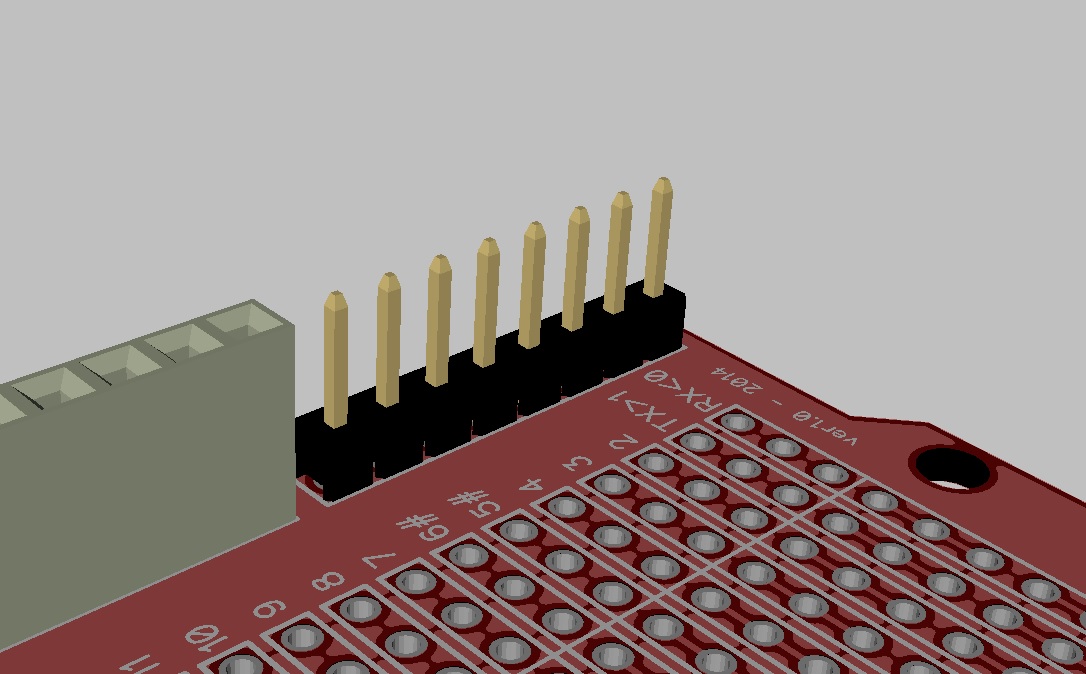

Now you're see you're new pattern on your pcb, Job done! :)

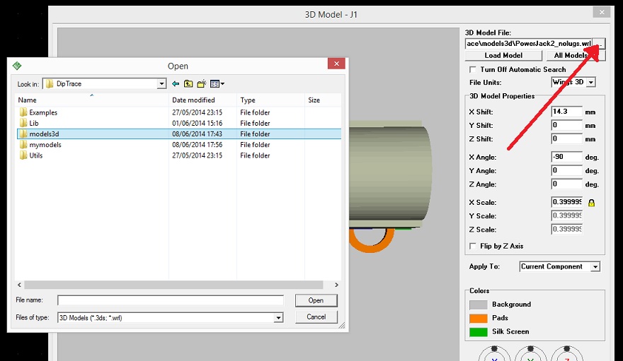

Next you will need to manually search for the component 3D pattern within Diptrace, open the 3D editor by right mouse click on component and selecting "3D Model.."(this is explained in the tutorial above). Find the new folder you created above with your component 3D file/files in. The arrow in the screenshot below shows the button to manually search for your component file.
This shows how to manually find you're 3D files

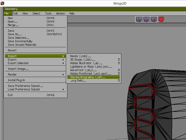

Here we download a different file type from the same 3DContentCentral.com of the same component, this time you want to download the STL (.stl) file, instead of WRL, but we need to convert this file into .wrl (VRML 2.0) this can be done by downloading the FREE software Wings3D.
We import the STL file that we have just downloaded into wings3D - the following screenshot below shows how to Import the STL file

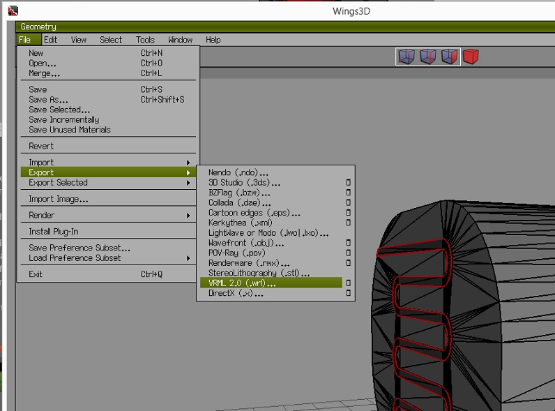

Once the component is imported we then just export the component but we need to select WRL 2.0.
This will make sure the file is now fully compatible with Diptrace, save the file in C:\Program Files\DipTrace\models3d
The screenshot below shows how to Export the 3D component into WRL 2.0

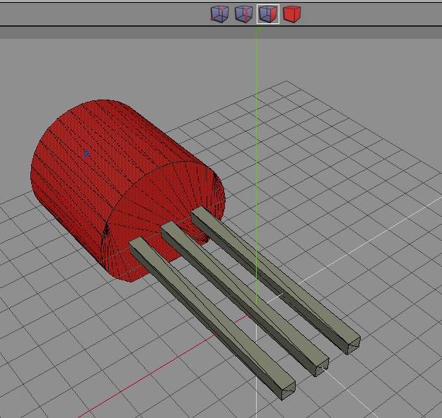

Now with the component in Wings3D you need to select the box in the top centre of the screen (see arrow in screenshot below)
Now you need to select all the component body, it's a bit like windows paint, use the LEFT mouse button to select all the bits of the shape (the shape turns red when selected)

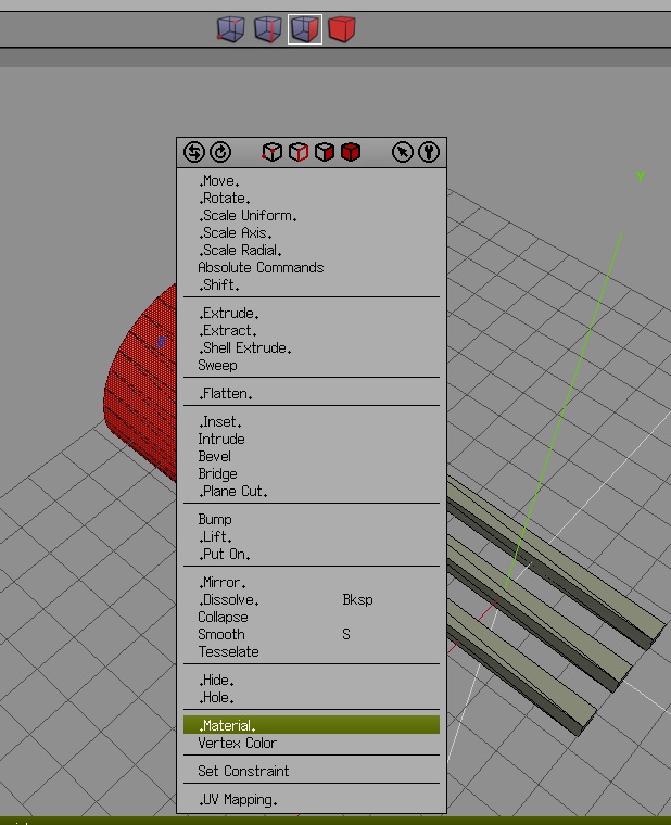

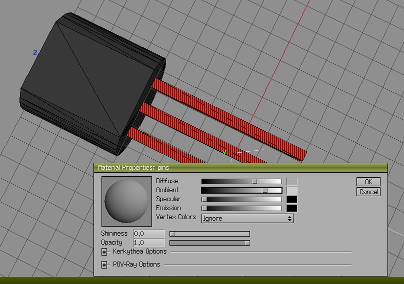

Next you now want to RIGHT mouse click on the component, this will bring up a selection list, you will need to select "Material", you must Right click on "Material" to create a new material!..

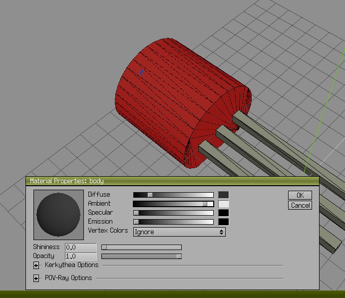

You should now be faced with a text box, here you need to enter the text "body" and press enter, next you will see another box pop up like the following screenshot. Adjust the Diffuse shade (color) this will show you the shade of the component body. Note: selecting full black wont give the component a great look when it's imported into Diptrace, I set Diffuse so the part looks slightly dark grey. Once you are finished just click OK..

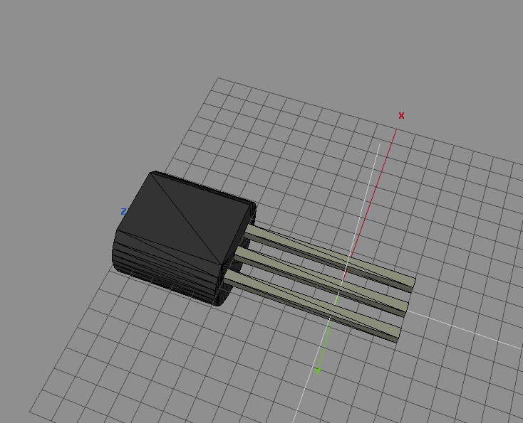

The component should now look something like this:
Do the same as before, this time select the pins of the components and right click on "materials" and enter "pins" in the text box.. You should see the same screen as before. I set Diffuse so the pins look almost silver. just click OK when finished..
Now for the last part, Export the component from Wings3D (Convert the file to WRL 2.0) and Import the component into Diptrace.
