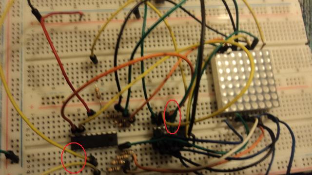

here's a few images from my breadboard :
the mark on the matrix is : XSM-D1088BRG
so, i don't think you have the same matrix as me...
what is the number of the matrix you use??

Im sorry to say this but your images aren't great? its hard to tell where the wires go. Im pretty sure its not a problem with your matrix has ive got several XSM-D1088BRG and they work fine.
But looking at your images the best I can, looks like 1 of the data lines from the microchip to the 7442 is missing? from pin 1 of the microchip to pin 13 of the 7442?.

Re: help with the screen
thanks!
i always forget this pic 1 to 7442 13..
i will try it again, and i will post a video of it
thank you again!

unfortunately those photo's are really dark and don't really show us what we need to see. Can you turn on the flash or a get a light close to it? Also can you try and spread the wires out evenly.
We just need to be able to see where everything goes. Here is a great example:
(Not that you need to label everything)

Unfortunately again, I can't really tell you what the problem is without seeing your circuit.
What code have you loaded onto the pic? Because if it was just the smiley face, it wouldn't be scrolling through the graphic data that slow.

Hi! I have made another video, seems like it is better i include the pic too..
http://imageshack.us/photo/my-images/585/dsc01350g.jpg/
http://imageshack.us/photo/my-images/818/dsc01349w.jpg/
http://imageshack.us/photo/my-images/9/dsc01345xg.jpg/
http://imageshack.us/photo/my-images/22 ... 342qn.jpg/
http://imageshack.us/photo/my-images/840/dsc01341o.jpg/
http://imageshack.us/photo/my-images/823/dsc01345k.jpg/
http://imageshack.us/photo/my-images/68 ... 346zk.jpg/
http://imageshack.us/photo/my-images/204/bb4v.jpg/
Yes you've got it!
All you need to do now is decrease the delay that it draws each of the eight columns. Here is the original delay in the smiley face code:
Try Changing the number 255 to something smaller - like 5 (maybe you could keep experimenting with different numbers and see what point the screen stops flickering and gives you a nive steady smiley face picture)
By the way - what was the problem in the end? was it a wiring problem or a code problem?

it was the wiring...

it was provided by bigof, but i don't see any numbers scrolling, thanks for all brad!

i would like to scroll some text like : happy birthday ... is it possible to do that with the same wiring as the brad's smile

Have a look through the great race code and modify the track data to suit your text. (The great race just scrolls a table of data - so putting text in there will scroll the text)

is it possible to have a draw of the great race like bigof did for me the other day?brad wrote:Have a look through the great race code and modify the track data to suit your text. (The great race just scrolls a table of data - so putting text in there will scroll the text)
