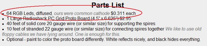

I'm thinking of making one of these 4x4x4 LED Cubes because it is cheaper than buying one.
Charliecube is a 4x4x4 tri-color LED Cube by Asher Glick:
http://aglick.com/charliecube.html
I'm looking for the right RGB Leds as I have none.
I see several Ebay offers:
http://www.ebay.com/itm/100x-5mm-RGB-LE ... 256a91b0c9
http://www.ebay.com/itm/100x-Bright-RGB ... 336fbe7c06
http://www.ebay.com/itm/100x-5mm-RGB-LE ... 2317b45afc
These are 4000 MCD which might be really really bright or too bright:
http://www.ebay.com/itm/100-pcs-5mm-RGB ... 4cfc58dc75
I'm even open to Mouser or Digikey orders if they are cheaper.
Any help making sure I get the correct parts would be appreciated.

The 4000 MCD Leds would probably be too bright, by the looks of it they use Common Cathode LEDs so make sure they are Common Cathode.
So these should be the right ones:
Common Cathode RGB

Thank you. I bought a pack of 100 RGB Leds. Hopefully a majority of them will work. I'm not sure if I'm going to use my Arduino or buy an Atmel 328 and FTDI cable. Maybe in the future I can build a larger cube.
