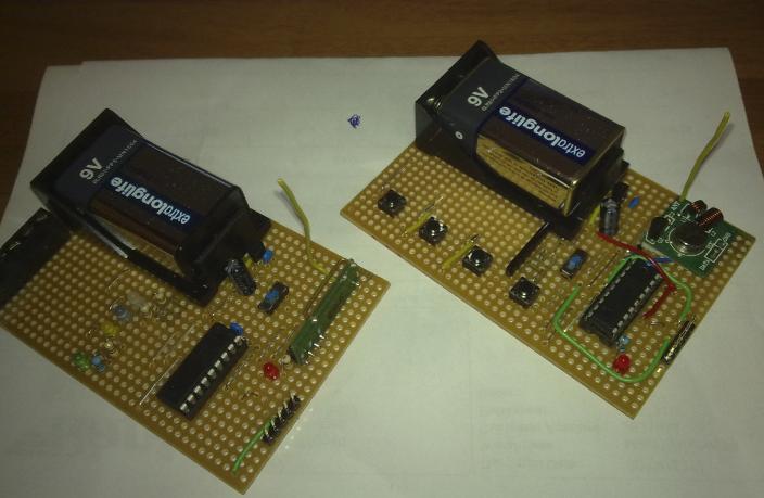

Post by bitfogav » Wed May 19, 2010 7:34 am
This is a picture of the prototype transmitter and receiver boards that ive made and been using to get the code working correctly..
Post by brad » Wed May 19, 2010 10:12 pm
Looking very professional indeed!
I had a quick look through your code and like the way you're going about it - It's great to see how people work around a problem in very different ways to others :D

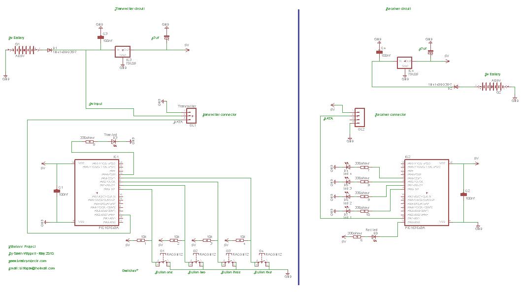

I would like to also do some schematics aswell for the project but Im still learning on how to use Eagle software... :)
Post by bitfogav » Fri May 21, 2010 4:58 am
still working on the receiver code but I just wanted to upload my schematics of the transmitter and receiver modules.. :)
http://www.bradsprojects.com/phpBB2/upl ... ss_207.jpg
