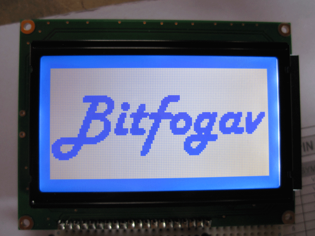

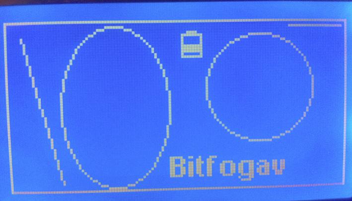

Hi all, Ive been interested in GLCD for awhile now and always thought they was some complicated devices. After receiving my GLCD 128x64 display recently (with a ks0108 driver) I got down to it and started making a demo programme using swordfish.
The displays seem quite easy to use, you can easily draw lines, circles, rectangles, ellipse, images, and even text.
Below is a demo picture of my GLCD using all of the above.. also my demo code below which ive commented to show what is going on, any questions please ask!.

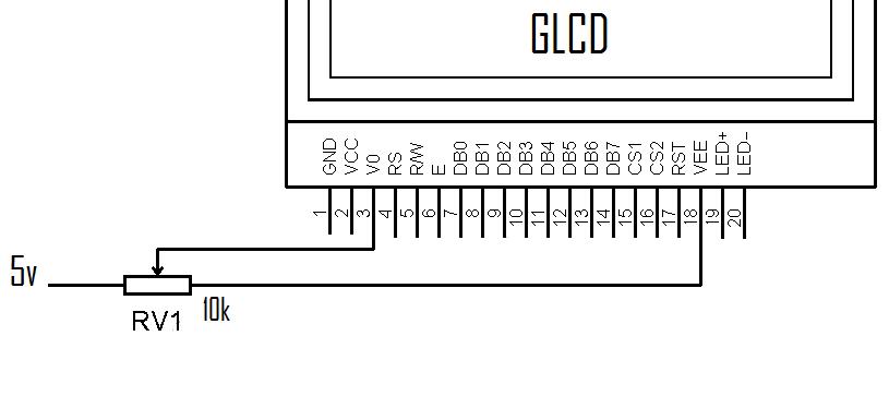

I've been playing with those in Isis. I got one from Sure electronics a few months ago and tried to set it up to an 18f4550.
One thing is confusing me though ... I presume that pin 3 Vo is used like a standard LCD ie through a 10k to earth/postive then adjusted for contrast. What is pin 18 used for Vee ? I've read its to do with contrast too ?
Can you shed any light please ( literally as I got no display :lol: )

Hi Jay, Good question, I had a few problems with this myself and took a bit of searching to find out how to get my display working, I was at a point of giving up when I looked at the datasheet again hehe!.
I assumed that you just connect up pin3 V0 to your POT as you would with a LCD 16x2, but you need to connect your POT directly to pin18 Vout/Vee aswell. Heres a diagram I just made up which might help explain how to connect up V0 + VEE connections.
GLCD Pot connections.jpg (27.54 KiB) Viewed 27008 times

Excellent Gav, works fine now thx very much :D

#Option GLCD_INVERT_CS = true       // invert CS lines...
// Modules
Include "glcd.bas"           // main GLCD module
Include "graphics.bas"       // support for GLCD
Include "utils.bas"          // support to make all MCU pins Digital
Dim x As Word
Dim y As Word
Sub incx()
x=x+2
delayms (20)
If x>=128 Then delayms(1000)
x=0
GLCD.Cls
End If
End Sub
Sub decy()
y=y-2
delayms (20)
If y<=0 Then delayms (1000)
y=128
GLCD.Cls
End If
End Sub
Sub drwscr()
    GLCD.Line(0,0,x,64)
    GLCD.Line(128,64,y,0)
    End Sub
TRISB = %00000000
TRISD = %00000000
x=0
y=128
// Main Program
While true
  incx
  decy
  drwscr
Wend

Very cool Jay :)
Im enjoying playing around with these displays :)
Re: GLCD Graphic LCD - Using Swordfish Basic
Post by bitfogav » Sun May 15, 2011 11:52 pm
Wouldn't say that this is very clear but this is my first attempt at a bouncing ball around the screen of the GLCD 168x64. you might have to look closely as the ball appears as a shaded line, as it goes around the screen.
https://youtu.be/xvAX6WoYnw0
Another version of it can be seen here:
https://youtu.be/gMMkN6ejdfI

Post by bitfogav » Mon May 16, 2011 12:30 am
Thanks Jay :D
Well the idea came from Brad and making a pong game but yes your right I could make a breakout game too :D
I guess its just finding the best technique to drawing the ball on the display to make it more obvious on the screen..
Looking forward to seeing what you come up with on Bitmaps, Ive tried a few GLCD font creators but didnt have much luck importing the data to Swordfish format..
As far as I can work out looking at the bitmap Module, the first four bits of the Image array are for the display settings.
So for an example the code below is of the Battery Image from the Bitmap module. The first four bits of the array are - screen settings (KS0108), width of image, height of image, and not sure what the fourth one is for.
public const BatteryImage(20) as byte =
      ($01,8,10,0,
       254,226,227,227,227,227,226,254,
         3,  2,  2,  2,  2,  2,  2,  3)
