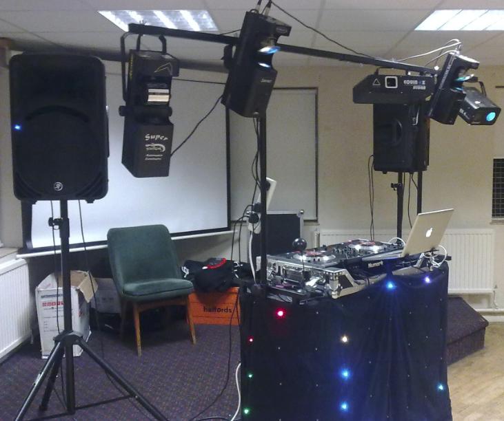

I actually have another hobby than electronics/microcontrollers/programming, DJ or Disc Jockey - I have my own setup of DJ equipment and also go on the road and perform at special functions (weddings, partys etc).
Ive had this idea for quite awhile now, making my own DMX Controller to help make some amazin Light Displays on my DJ equipment. - the guys at digital-diy have been working together to make some Swordfish (basic IDE) modules for DMX, but the information and modules are for a DMX Dimmer which is basically a DMX Receiver (light unit)
I'm in the process of testing and prototyping, generating DMX packets using the DMX Protocol at the moment so when I have more ill share :)
heres a pic of my setup equipment.

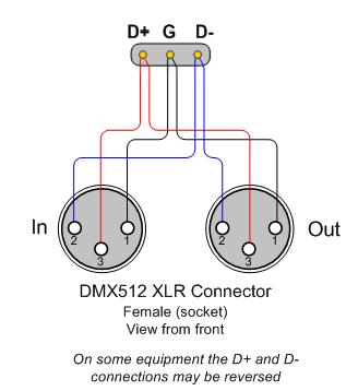

Well thats a good question, DMX uses 3 connections, 1 Common, 1 data line (+) and 1 data line (-) On my setup I had to reverse the data lines on some of the equipment (receivers/Lights) as some of the DMX receivers on my setup use the reversed type connections, thats the only reversed engineering ive come across. This is easily over come though has you can buy adaptors to put onto the data lines which reverse the data lines for you, for example heres how the standard connections for my 3 pin setup looks like:

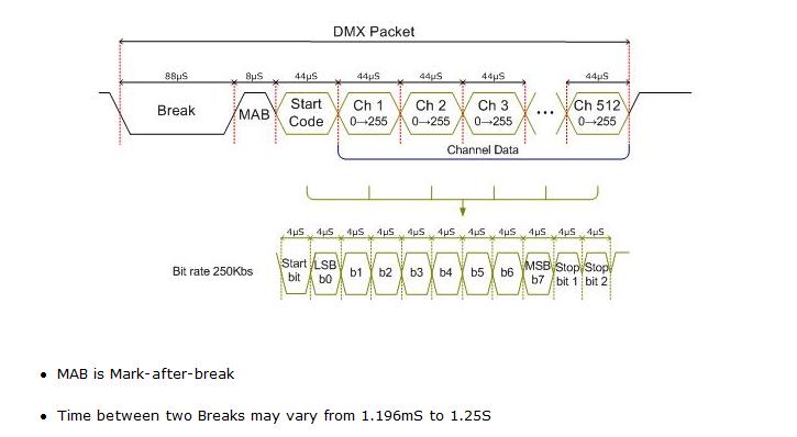

Has I am aware there seems to be a standard DMX protocol which you can see here
DMX Packet.jpg (30.19 KiB) Viewed 24432 times

brad wrote:I find it interesting that there is no clock pulse for which to synchronise the data to.
DMX is based on Asynchronous data transmission, data is sent one byte at a time.
Asynchronous devices do not require perfect synchronization and one device functions as the master (the DMX controller) on a network, while the rest function as Receivers (dimmers, intelligent fixtures, etc.). Only the master transmits over the
network, and all Receivers receive the same data (512 channels).
Devices are connected in a daisy-chain fashion, from the controller to device #1, then device #1 to device #2, and
so on.
DMX 512 data is transmitted at 250 kiloHertz (kHz), meaning that 250,000 1’s and 0’s (at a maximum) can be
sent each second. Each bit is measured in 4 microsecond (μs) intervals. In order for the receiving device to
correctly interpret the data, it must be sent in a particular sequence. A single transmission (DMX Packet)
includes synchronizing elements and channel data for up to 512 channels.
dmx protocol2.jpg (10.12 KiB) Viewed 24429 times
