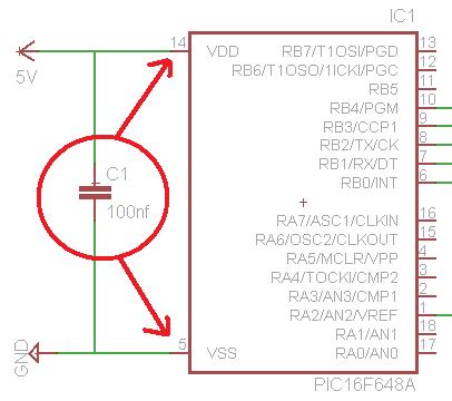

As I was looking trough some schematics I noticed that nearly every schematic has a `electricity filter` (I know it has something to do with noise and capacitors). My question about this: Why would you need to filter electricity? What is causing that noise? Do I need a filter on my project? How to make such a filter?
Post by Chuckt » Fri Jul 02, 2010 6:06 am
My dad said that capacitors are like shock absorbers on a car. It has a way of smoothing it out. A lot depends on how they are made.
I suppose you could filter with resistors just to find that a little bit of it is still there.
Post by brad » Fri Jul 02, 2010 6:20 am
Basically you have a filter capacitor connected between ground and vcc of each chip. What can happen internally is that you get multiple transistors turning on which effectively creates a short circuit from VCC to GND.
Since this is only for a split second, it kind of looks like an AC signal (high frequency), since the capacitor looks like a short circuit to high frequency, it shunts the current away from the chip, through to ground.

Ok, can you make a small schematic of this? This will help me alot. Just as an example. As I understand I don't have to use large ones. 0.1hF will be enough right?

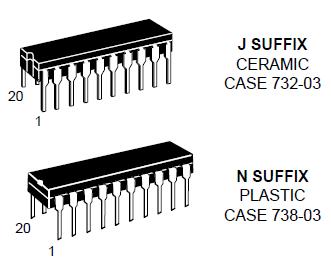

I have a question about the 74373 is there a big difference between the 74HC373 and the 74HC373N? I've got a look trough the datasheet but that didn't help me alot. (It only made me more confused).

aliw wrote:I have a question about the 74373 is there a big difference between the 74HC373 and the 74HC373N? I've got a look trough the datasheet but that didn't help me alot. (It only made me more confused).
http://cgi.ebay.com/50pcs-DIP-IC-74HC37 ... 4aa046eb19
It is in the datasheet, the difference between a 74373 and 74373N are the markings on the chip.. Thats all it is.

Here is an example of a capacitor filter on a 16F648A, I would recommend using a 100nf capacitor as this would do the job on most projects, And as for the pickit 2 and pickit 3 in your links above, they are CLONES, Im not saying that they would not do the job but just pointing out that they are copies? I would recommend the pickit2 has most of the people I know use them and I have got one myself and they are so easy to use, and I think the difference between a pickit2 and pickit3 are the types of microchips they will programme?, the pickit2 covers most of them but I think the pickit3 will do them all?

The capacitor is there to shunt any AC or high frequency noise to ground. In high speed devices like a microcontroller, it is easy to generate unwanted noise. A capacitor is basically a short circuit to high frequencies (but open circuit to DC) so it will shunt through the cap instead of through the chip.
