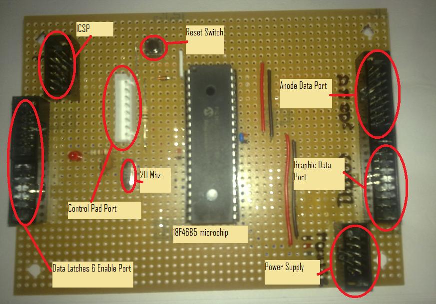

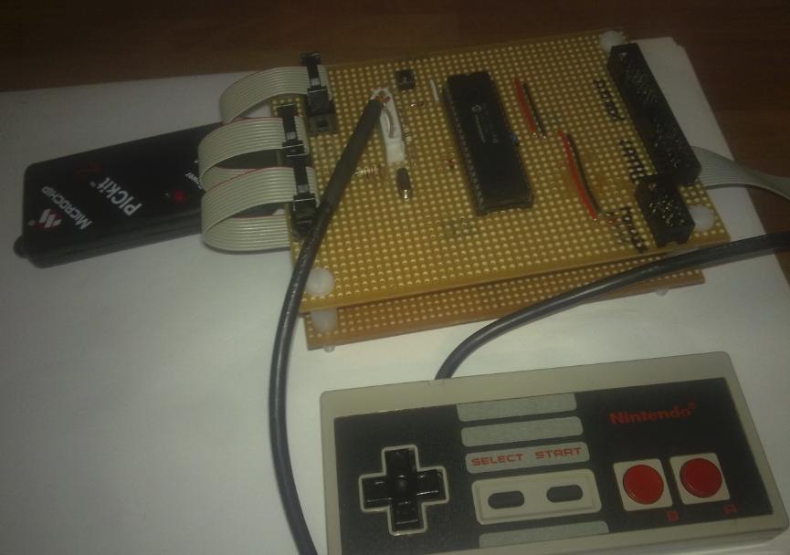

Post by bitfogav » Sat Sep 04, 2010 7:07 pm
brad wrote:That's a great idea about pacman!
you could play it all on the one screen without the screen having to scroll.
Will certainly have to port the code over to the new screen :)
Well thanks to you Brad and seeing your NES control pad on one of the other forum threads I have now fitted a Control Pad Port to my 24x24 microchip board, this will easily give me 8 buttons from just 3 data lines, Ive actually connected all six I/O PORTA pins to the Control Pad Port for future hardware applications and also have a 5+volt and GND supply.
I have also looked into using a Playstation Control Pad, some of them have a Dual Shock control, which vibrates the control pad when it is powered up by a 9volt supply only on one of the connector lines, so imagine a racing car game where you hit another car or a wall and it vibrates your Control Pad :)
microchip board edited.jpg (80.52 KiB) Viewed 22986 times
Post by brad » Sat Sep 04, 2010 7:51 pm
Man that is a cool looking board, nice and neat :)
The NES controller works perfectly, there's never any hiccups - just a few lines of code and it's all good to go!

brad wrote:Man that is a cool looking board, nice and neat :)
Thanks Buddy :) im almost ready to give my NES controller a go..
heres a pic of the NES controller connected and my microchip board made up, oh and with my PicKit2 connected.

Thanks to Brad ive have been able to connect a NES control pad to this project quite easily and I have made a Race Car game which you could also say is based on one of Brads games. the game is still in the early stages so its pretty basic. but I am very impressed with the NES control pad!..
You might also see the fully working contol boards that Ive also made up to control the matrix in the video.

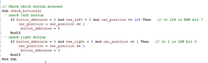

For some reason the subroutine "check_buttons" from the code above will not come out correctly when put in a forum code box, so here it is.
