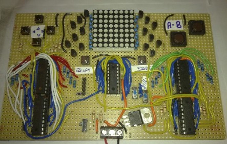

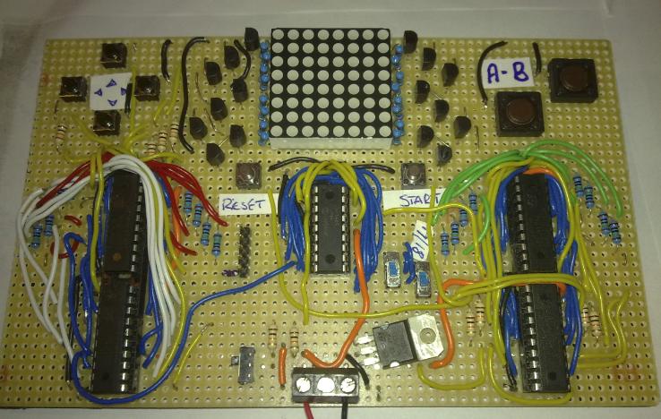

I am really impressed about all your projects too and enjoy getting out your 8x8 matrix car game that I built onto a circuit board :)
I know it looks abit messy lol :)

Cool looking game system you have there :)
I have been thinking for a while to make a two player game system where you could (perhaps) play via wireless link.
I was in the process of designing one quite a few months ago but haven't actually finished it. My original design just used wires to connect the two games together.
By the way, for only been having used microcontrollers for a year, your skill level is quite impressive.
I think it would be great if we all lived close to each other - then we could meet up and build some crazy big project!

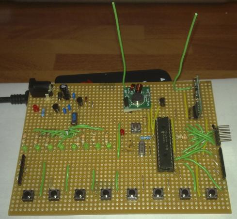

Post by bitfogav » Mon May 24, 2010 3:31 am
And heres the prototype board that ive also made..
