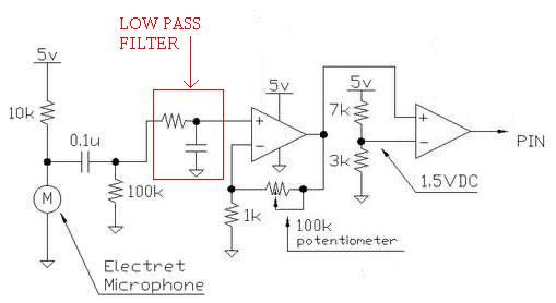

Ive been making this circuit below and trying to add a low pass filter has ive highlighted in a the red box below but not having much luck with it, you say that the resistor and capacitor as to be in series?.
ELECTRET MIC - Low pass filterbox.jpg (12.79 KiB) Viewed 21853 times
Re: DMX Controller
Post by brad » Thu Feb 17, 2011 10:19 pm
I was just basing it on the very simplest form of passive filter.
The circuit that you have is an active filter which not only acts as a filter, but it also amplifies the signal aswell.
Although I have to say, I have never seen an op-amp filter used in that configuration before.
Where did you get the circuit from?
Do you actually need it to amplify your signal?

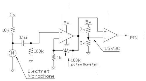

Post by bitfogav » Fri Feb 18, 2011 3:01 am
ELECTRET MIC1.jpg (13.25 KiB) Viewed 21849 times
This was the original circuit that used two op-amps, one as a amplifier and another op-amp which is used as a comparator, the electret mic only produces about 0.3ma so it needs to be amplified and then the use of another op-amp has a comparator (which gives us an 0v output unless the mic detects sound and the comparator will give us 5v output, I was just using a I/O pin of microcontroller to detect the output).

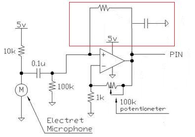

Post by brad » Fri Feb 18, 2011 5:20 am
I see the reference is 1.5volts (which would be a logic 0 for the uC) What is a valid logic 1? is it just above 1.5v?
I have modified the circuit slightly to include a low pass filter at the input.
ELECTRET MIC1.jpg (16.46 KiB) Viewed 21848 times
to get your cut off frequency, you need to put some values into this formula:
cut off frequency = 1 / (2 x π x r x c)

Post by Mitchy » Fri Feb 18, 2011 5:41 am
Looks like we're both on this one Brad :)
I suggested otherwise as the impedance of the RC filter would be too high for the mic to drive. Perhaps placing the filter on the low impedance opamp output would be ideal - the opamp could easily drive the rc filter and the output is going to a high impedance comparator (no issues with impedance matching).
I also went on to explore the roll-off of the first order RC filter. It's quite a long saggy curve and might be annoying to use for [clean] beat detection?

Post by bitfogav » Fri Feb 18, 2011 8:25 am
brad wrote:I see the reference is 1.5volts (which would be a logic 0 for the uC) What is a valid logic 1? is it just above 1.5v?
Brad, yes the second op-amp which is setup to work as a comparator is set to output a logic 0, when a loud sound is generated and amplified to a voltage higher than 1.5v, then the output will go from 0v to 5v until the voltage at the (+) falls below 1.5v? which will give us our logic 0 again.
I will try out what you have suggested over the next few evenings, thank you for your help and input. :)

Post by brad » Fri Feb 18, 2011 10:34 pm
I didn't think of that at all mitchy!
And you are right, we would want to use the ideal input / output conditions of the op amp in order to actually get the mic working.
You can increase the roll off by connecting a cap between the out put of the opamp and the inverting input

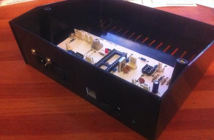

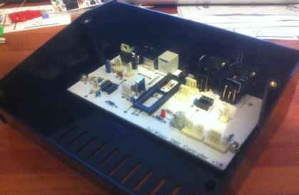

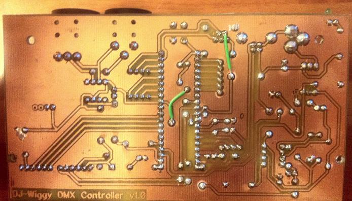

Just an update:
The DMX Controller is coming along well, PCB almost built, desk console coming together now and then to finalize some more things.
Heres a pic of the Desk console.
Re: DMX Controller
Post by brad » Sat Mar 12, 2011 7:34 am
Nice professional job :D
Are you using overboard with paper over the top? I think i remember seeing you do that before - looks great!
Re: DMX Controller

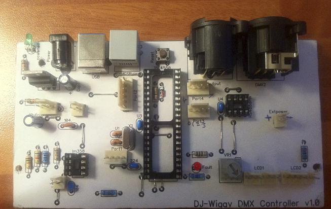

Post by bitfogav » Sat Mar 12, 2011 7:39 am
Thanks matey :)
Im using copper board with my pcb design on it and then yes paper overlay with the top silk from Diptrace, I feel it gives it more of nicer finish! :D
As you can see there is two green link wires on the pcb which I forgot to connect lol, which has now been corrected on the Diptrace pcb
