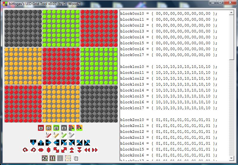

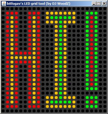

Just thought I would post a screen shot of what I am having made to support this 24x24 led matrix :)
Post by brad » Mon Aug 02, 2010 10:35 pm
Thats really cool, did he do that in visual basic?
Do you have to click each individual dot or can you click and then drag your mouse to draw lines etc...?
Post by bitfogav » Tue Aug 03, 2010 2:49 am
Hes added some key listeners, so you can hold down a key and move the mouse to draw lines of colour (Red,Green,Orange), or just single dots. He has also added some key listeners for other keys that will turn the whole screen one colour etc.
I have said that maybe at some point we could add boxes which gave you binary code or array data, so you can just copy and paste it into your code? it is still in the early days at the moment so when I have finished the 24x24 matrix circuit we will make changes as we go :)
I would also like to use it to communicate from the PC to the microchip and draw what you are drawing on the PC onto the 24x24 matrix.
I think he made it with a Java based program, I will find out for sure.

Post by bitfogav » Wed Aug 11, 2010 4:20 am
here is version 7 of the LedGridTool that I am going to use to impliment code and draw graphics hopefully for the 24x24 matrix..
will hopefully get round to finishing my 24x24 circuit soon and then the good bit, SF programming can get going!! :) even though thats going to be a BIG challenge!...
Post by brad » Wed Aug 11, 2010 5:58 am
Wow man, that is looking really cool!
So it looks like you are using 2-bit binary for the state of each led
00 = black
01 = red
10 = green
11 = orange
This is quite interesting because I was looking at down it a different way whereby you would have separate red and green data tables. I like it that there are multiple ways of achieving the same result.
When do you think programming can begin?
