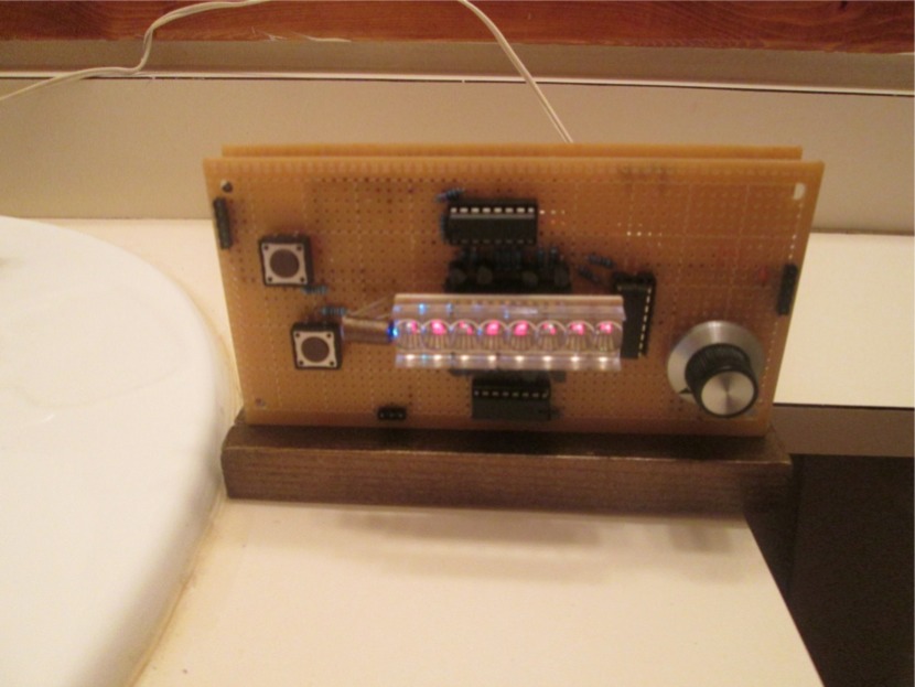

I needed a clock for my room and I had already bought a few of these bubble displays from ebay since they looked pretty cool. I had already made a circuit board with shift registers connected to the display to test them out, so I decided to finish it by adding the necessary circuitry to run it. It turned out pretty well, the display is pretty small (I believe it is some sort of old calculator display ) but it looks very good especially with an added LED back-light shining into the display(RGB of course.) I also added an RTC, a speaker for an alarm, 2 buttons to switch between modes,and a potentiometer set the time of the clock or to select other options that are in the different modes (such as switching between octal, decimal, or hexadecimal time, changing the color of the back-light, setting an alarm, etc.)
The programming the clock is a work in progress (Brad's recommendation of VISUAL MICRO is very helpful) but it does display the time and do basic stuff, it just doesn't have all the modes programmed in. I'll post pictures later, and maybe even a demonstration of the clock if anyone is interested in that (after the programming is done.)

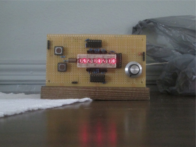

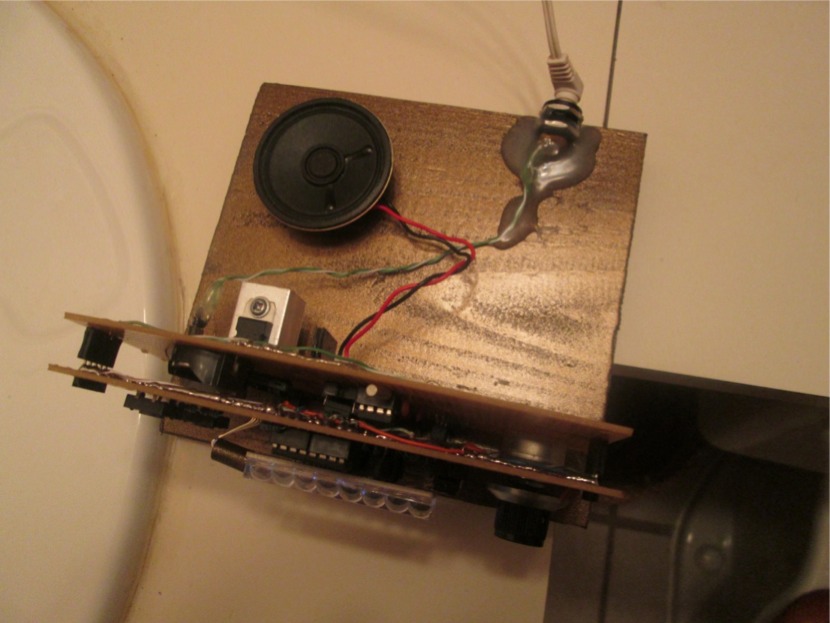

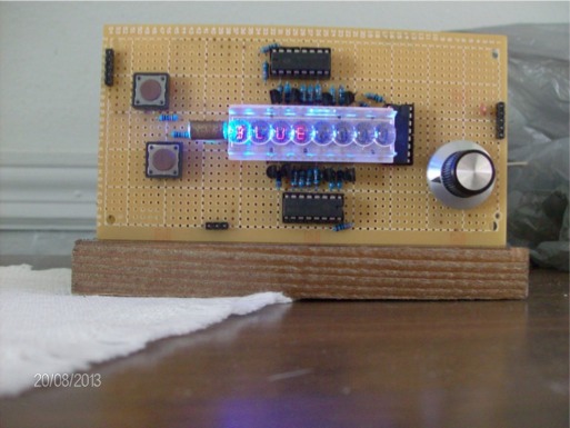

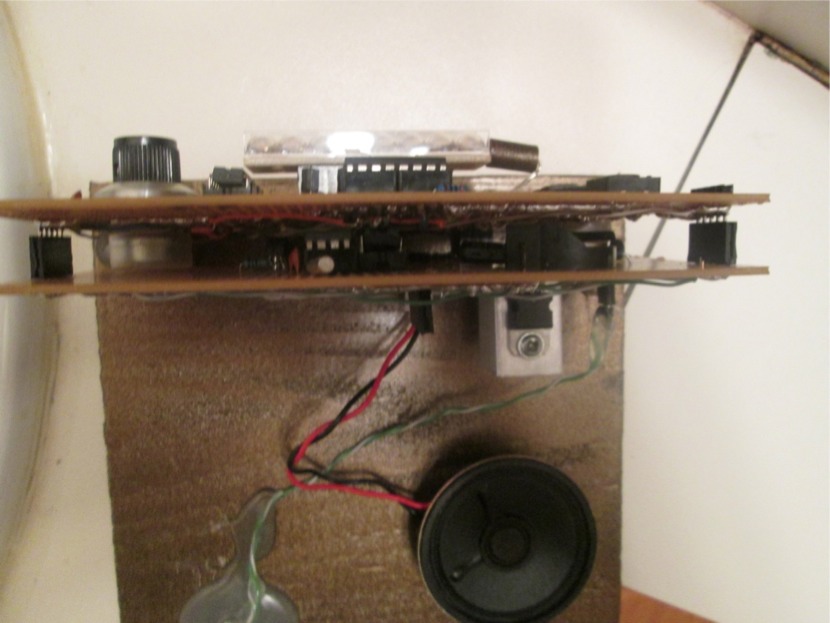

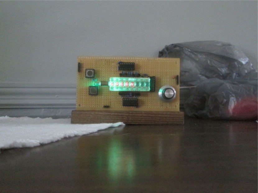

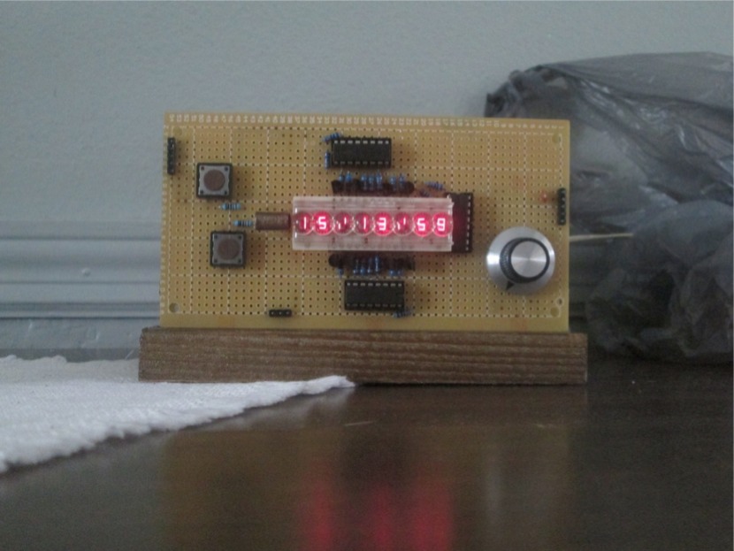

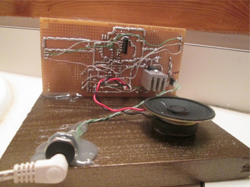

Now for some more interesting stuff. Below are (should be) some pictures of the clock, which as with all LED type devices looks better in person. It has 8 digits with an RGB backlight which can be programmed to be whatever color the user desires and saved as the clock is running ("GREEN", "RED", and "BLUE" is shown when selecting the brightness of each color and can be seen in the pictures.) You can also set the clock to show the time in 24hr or 12hr mode and even in octal, decimal, or hexadecimal (a binary setting should be coming soon.) A modified version of the Arduino's basic PlayMelody code (modified so other tasks can be performed as a melody is playing) allows basic melodies to be played when desired or as an alarm. Two buttons allow navigation through the settings and features, and the potentiometer is for selecting stuff in the features (setting the background color, setting the time, choosing which melody to set as the alarm, etc.) Yup, pictures now.
