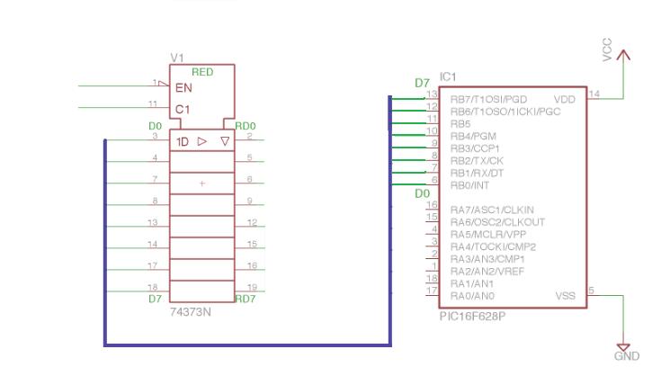

Heres a diagram of basically how to connect a 74373 to a pic16F628a..
has you can see that you need to connect 8 pins of the 16F628a to the 8 D-pins of the 74373.
Dont forget though that you also need to connect pins 1 and 11 of the 74373 to your microchip to latch the data and enable the 74373 to output your data.
note, the blue line from the 74373 to the 16F628a is actually 8 connections or wires, depending on your project :)

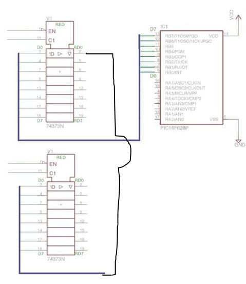

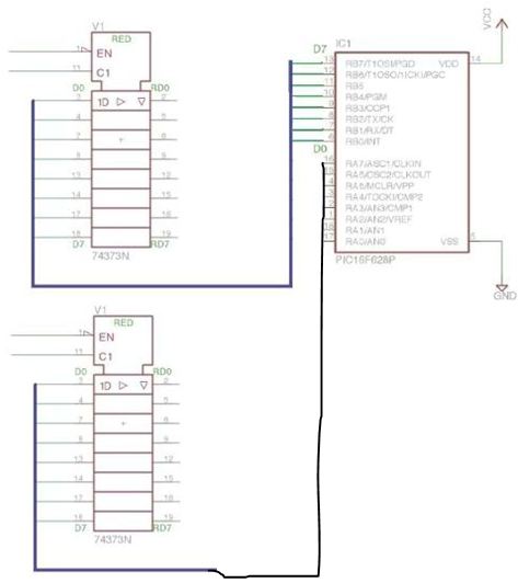

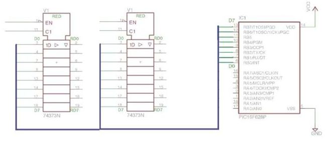

Ok, I just don't understand how to connect the 2 IC's. What I understand is that I need to connect 8 pins from the pic to the 8D pins of the 74373 separately. But what is the point when you do that? (as you don't expand your design at this point. When you just use one 74373.) Can you just connect those 74373's in parallel?
I will make some demo schematics, and I will be grateful If you tell me which one is correct. (As for my project I am going to buy 100 GRB's so I will be just using 96 because 96/8=12 and 12*3=36 so I will need 36 74373's. Is it actually possible to connect those 36 74373's on one PIC microcontroller?)
demo schematics:
http://www.bradsprojects.com/phpBB2/download.php?id=33
http://www.bradsprojects.com/phpBB2/download.php?id=34
http://www.bradsprojects.com/phpBB2/download.php?id=35
sorry for ugly paint lines. what program are you actually using to make these schematics?
Post by brad » Thu Apr 29, 2010 9:02 pm
Yes, the last one is right!
you can connect 36 of the 74373's to the same 8 pins from a microcontroller (as long as the microcontroller has enough pins to then be able to address those 74373's)
So in the example of the link above, you have two 74373's both connected to the same 'data bus' of the microcontroller, this means that what ever data is on those 8 connections, both of the 74373's will have that data on their inputs, you then send a logic 1 to the 'C1' connection of the particular 74373 that you want to store that data.
So in the example of using 8 RGB LED's, you would need 3 of the 74373's.
You would connect all 74373 inputs to the same 8 pins of a microcontroller. you would first send out 8 bits for the red leds. even though all three 74373's receive that data, you would only send out a quick logic 1 to the red 74373, C1 connection (this will save those 8 bits to that 74373.). you then send out the 8 bits for green, then send a quick logic 1 pulse to the green 74373, then you do the same for blue.
then when they all have their data stored within them, you then send out a logic 0 to all three 'EN' connections. this will then send all the data stored in the 74373's - to the LED's

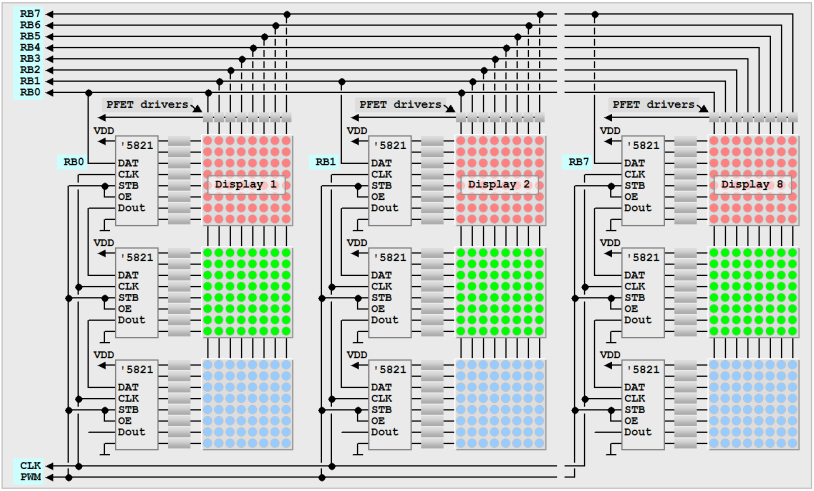

Basically to run 36 74373's chips you will need a microchip with atleast 80 outputs/inputs and as far as I know in the 8bit range there isnt one available at this moment, you would have to use a 16bit microchip. :)
the other option is to use a completely different design for an example
the project below.
