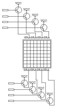

You just need to repeat this circuit until you have all eight outputs of both 74373's connected. One of them controls the transistor to provide VCC to the anode. The other one provides a ground to the cathode. (when you place a logic 0 on the 74373 output. If you are using a bi-colour display you just need to add an extra 74373 and connect it to the other colour cathodes (because they are common anode)

Post by nicolo86 » Sun Jul 25, 2010 10:20 pm
Now i am rally confused. Sorry but i am not that great with curcuits.
So in your schematics you showed that the red and green cathodes connects to the resistor, then the transistors, again the resistor, and finally the chip. as shown int the schematics, but where i got lost is when you told me that the common cathode gets one resistor and one transistor, and the red and green cathode doesnt gets the 2 resistors and the one transistor.
So exuse my ingnorance, and please can you recap what connects to the different pins.
Tanks for all
-nicolo86-
