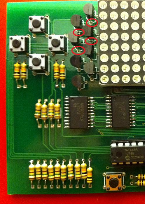

I know how frustrating it can be when something you've put together dont work.. you say you think it might be the power supply on the tracks on the left of the board?? :roll:
If you mean the ones on the front of the board then these power up the transitors, you can check power supply to the pins on the transitors has shown in this picture below:
The other thing what 8x8 matrix are you using?, did Brad supply you with the 8x8matrix? Or where did you get it from?.

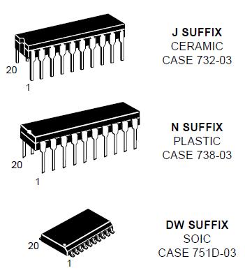

Post by bitfogav » Sat Oct 15, 2011 9:35 am
All 74373 function in that same way. the "N" at the end of the 74373N is just a package type depending on manufacturer for example:
J = CERAMIC
N = PLASTIC
DW = SOIC
